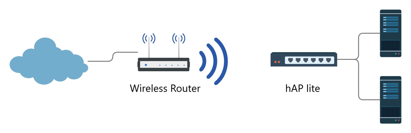

I have a couple of wired-only security devices I can’t move in a room that I can’t run a cable to. I’ve got a hAP lite (not AC). I want the hAP lite to connect to the existing wifi, not repeat it or create it’s own wifi network, plug in both devices to the ethernet ports and have them on the the same network as if they were connecting directly to the router, no NAT/Firewall/DHCP.
I made a probably not very helpful diagram:

But the purpose of the devices is for other devices on the network to access them, not for them to access the internet. I imagine I probably have to do something quite different but I’m not sure where to start.

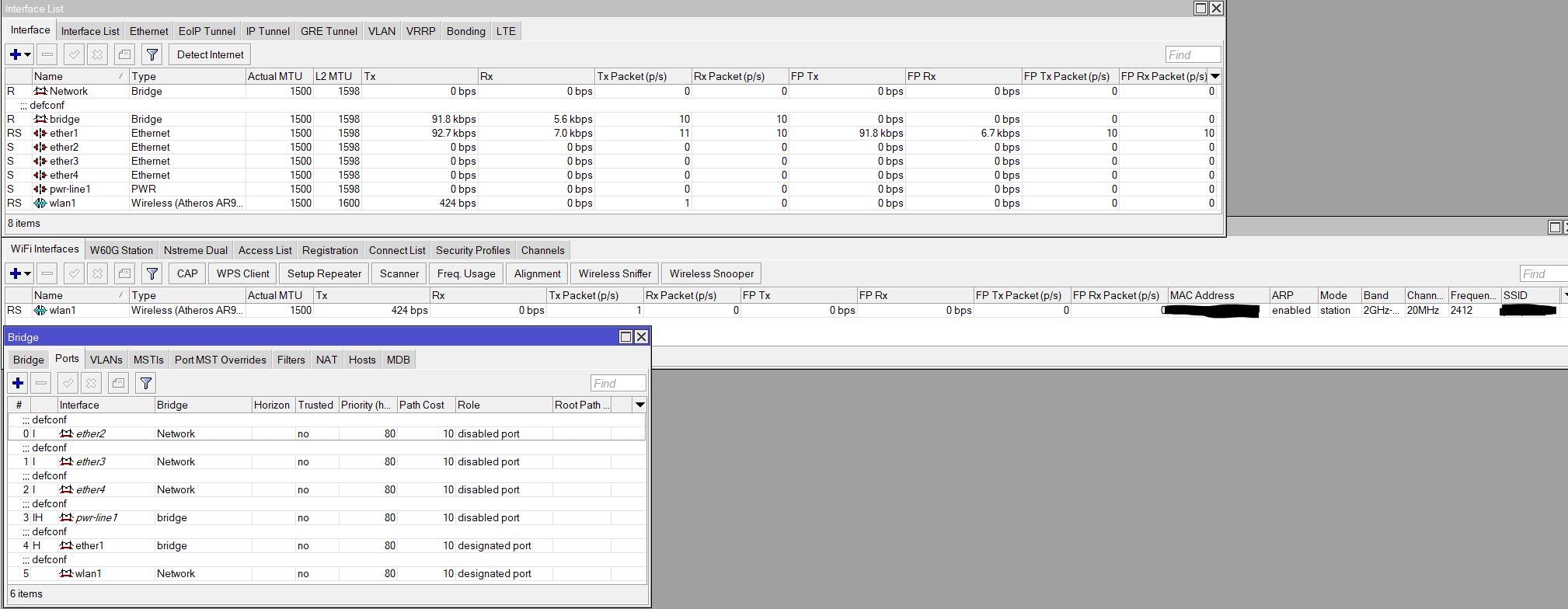

Thanks. I just gave that a go. I thought it worked at first. It’s passing through DHCP from the regular router to devices on the LAN ports. But no other traffic. Can’t connect/ping from those devices out to anything local or internet and can’t connect/ping from anything else local in to them.
Here’s a winbox screenshot if it helps. I’ve left the WAN port out so I can more easily get back into winbox using that port.
If you’re connecting to non-MikroTik AP, here’s some suggested reading:
https://wiki.mikrotik.com/wiki/Manual:Wireless_Station_Modes
Not a very good idea unless you are connecting on one freq 2.4Ghz and then re-tx on a different radio ie 5Ghz… Otherwise your traffic throughput will suffer terribly.
Depending on the type of wireless device you’re connecting to, you need to verify the station type under your wireless interface settings.
station-bridge is ideal if the other router is a MikroTik. Otherwise you can try station-pseudobridge, but you’ll have some limits outside of IPv4 traffic.
If it’s set just to ‘station’ , bridging won’t work.

@IPANetEngineer - that did it! You dead set legend! That was the only other required change. I think basic IPv4 is all I need for these things so that shouldn’t be an issue.
