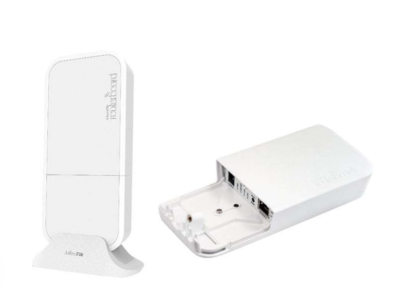

Hi!
Obviously I’m new to MikroTik but now my way around the basic stuff. I got a MikroTik routerboard wAP (the one in the image below) and planned to use it to extend the range of my wifi network coming from a non-mikrotik router. At first, I just connected them by the ethernet cable (PoE to use it for power and internet) and everything worked fine since it provided me with a new network to which I assigned an SSID and a password.
My problem, however, is that i have smart lights which are connected through a gateway. This gateway was connected to my original (non mikrotik) router through power via TPLink ethernet powerline extenders, since the MikroTik routerboard doesn’t have another ethernet port. Because of this, you can only use the smart lights while connected to the original network, but the lights are located in an area where you can only access the MirkoTik network, which can not be used to control the lights.
I wanted to ask if there was a way for me to use the router board to only purely extend my original network (mirror it) to a wider range? I’ve tried using bridge mode, but then I just lose the MikroTik network and have to reset the routerboard. Then I tried to set it up as a repeater, which technically worked as I got my original network extended, but that made the wifi extremely slow, barely even existant.

This is an extra AP to your network. There is no quick setup entry to select but the setup or correction is easy.
Bridge ether1-Wlan1 and Wlan2 together
The bridge is a LAN connection.If there is still a LAN and WAN list, add the bridge to the LAN list, and remove ether1 from the WAN list.
There is no need for a DHCP server on the bridge, remove it, the IP addresses come from your first router.
Give IP address to the bridge or add a DHCP client to the bridge (not to ether1)

Actually it’s very simple. You have to add a DHCP client to the bridge, and connect the ether1 to the bridge.
If this works, then remove the DHCP server from the bridge.
And so you bypassed the DHCP server, NAT to ether1 and the firewall protection that disabled access from ether1 to the rest of the LAN.
