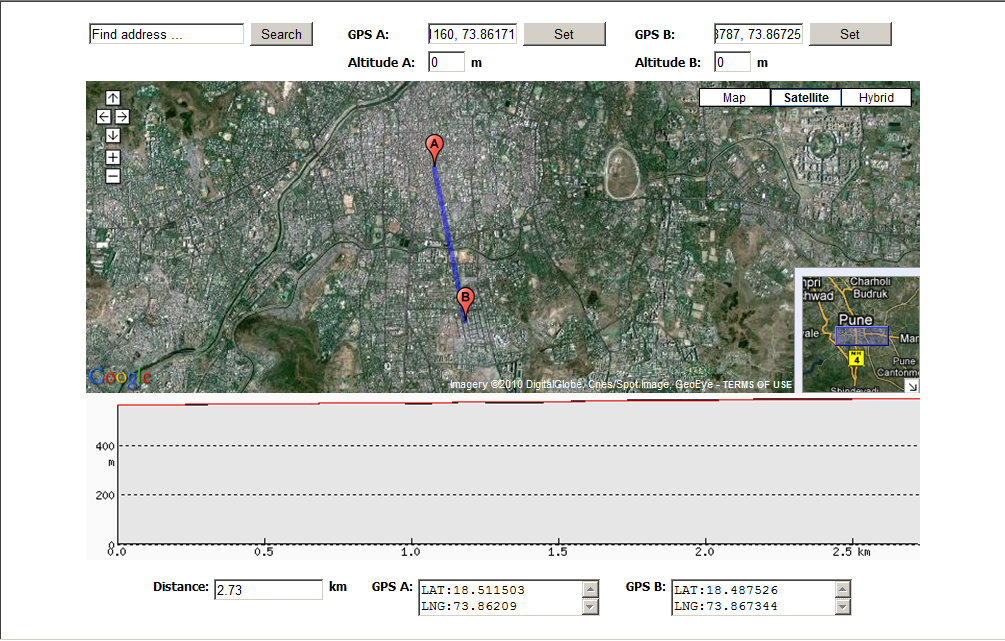

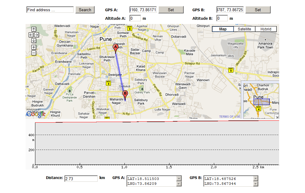

this is what i want to achieve.
1.> heavy urban area.
2.> los only if taken to 40mtrs above the 4 storey building
3.> lot of mobile towers and other ISP systems working around.
4.> need atleast 40-50 mbps in bridging mode (PTP)

I do believe you can. In fact everything depends on your situation: cleanness of the air, antenna hight, line of sight and so on.. In my personal experience I was able to improve my 5km link by placing RB711 with 23dB panel antenna. My link is quite complicated, there are few trees in the way, both antennas aren’t placed very high and the terrain between them is quite flat. I think fresnel zone is not fulfilled as it should be. I’m using ordinary 11a mode and max throughput stays about 30mbps all the time. Simple FTP download hits 3.5mb/sec.
do you have photographs of the site/location?
would be interested in seeing those. i am facing a similar situation.
