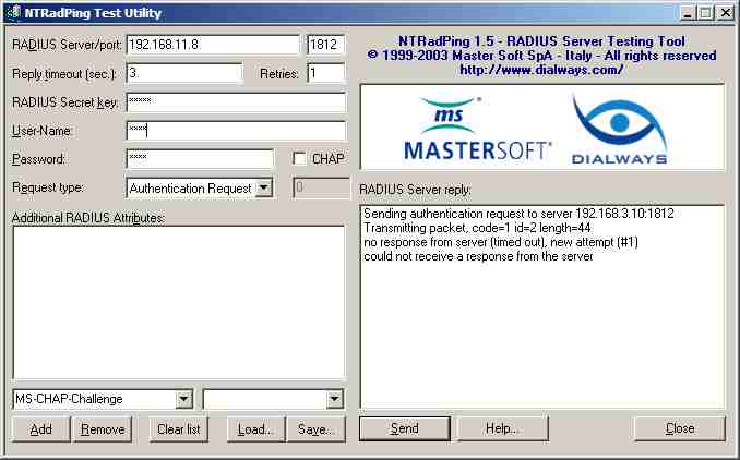

Im also have Userman on x86 Ros v5.22 and I want to give some other network usage to same users which is already in userman base …
Is it possible to the existing RADIUS server access to some external method?
For now, I’m trying to make a connection with NTRadPing … but no luck …
If anyone knows the settings with which you can connect, please help.
I always have errors like in this picture :
