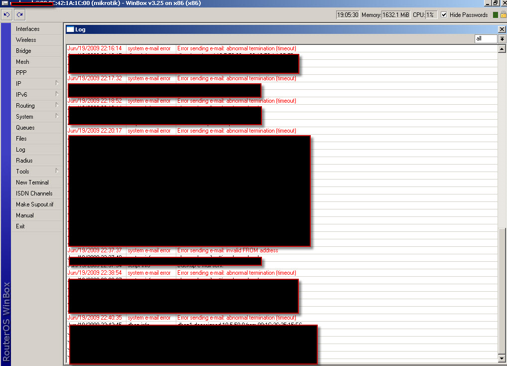

v3.25 script backup not work !
Hi all
two days to make that script do the job. but but but
it not work !!!
ok
am testing many e males in gmail & my won ISP mail… not work !?
why
mikrotik cant have SMTP inside its own os !
its possible or what ?
am very angry i know that from two days a go … but i need answer its work gentleman for any one !
we need any solution for that thing…

i am trying to hide the name not the mac…
just tested on a 3.25 board here with my msn account, and it works.
try to add this in your gateway nat:
add action=masquerade chain=srcnat comment=“email test” disabled=no dst-port=25 protocol=tcp src-address=“ip the routerboard that is sending mail”
before any thing which script work with you ?
are you accommodate email setting ?
you write any thing in user or password column isn’t you ?
some details to do effectually please..
thanks a lot for your comment ..
regards
I didnt use any of your scripts, I only used the email line since it is the one that fails.
I tested using this line:
/tool e-mail send to="myhotmail@hotmail.com" from="myhotmail@hotmail.com" user="myhotmail@hotmail.com" password="myhotmailpass" server=65.55.172.254 s
ubject="testing" body="testing testing" file=testfile
(the server ip there is resolved from smtp.live.com)
That worked, so then I filled out the smtp settings in /tools email menu, and only had to use
/tool e-mail send to="myhotmail@hotmail.com" subject="testing2" body="testing testing2" file=testfile
I dont know about gmail, but hotmail smtp requires smtp authentication, so user and password have to be sent, otherwise it will be ignored..
thanks alot Mr.Fosben
its work perfectly
