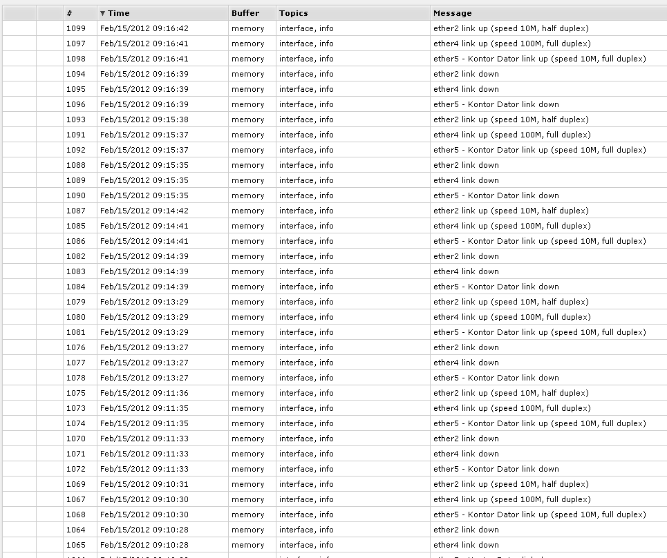

When updated to 5.13 from 5.12 I have got a problem with interfaces going up and down in irregular intervals. It can be running fine for a long time and then more often then on minute apart go up and down up and down. My WAN interface seems to be the only one that is stable. My switch configuration goes up and down. On that switch with four members there is 2 ports used. Nothing is connected to the master eth2 and also none to the eth3. Now the log is filled with ether5, ether4, ether2 link down and then short after ether5, ether4, ether2 link up and then the stats about them.
The stuff connected to these ports are a laptop and a dreambox.
Ether9 which is on the second switch chip has also gone up and down but has now been calm for the last 16 hours. To that port a cisco ata 188 is connected.
Hardware: RB493G.
I can send configuration and so on but right now my question is whether you have changed something from 5.12 concerning this? This is my home device so it’s no big deal but I’m not comfortable to update the production ones…

Did you remove firewall filters from default configuration?
We have found what caused this. Problem will be fixed in next version.
I see the same behaviour, it seems that the interface stays up when a winbox connection is open and there is a constant data flow. It starts going “down up down up” ~2 minutes after closing the winbox connection. Seems to be some sort of misconfigured ethernet energy saving :laughing:
Ticket #2012021566000546
