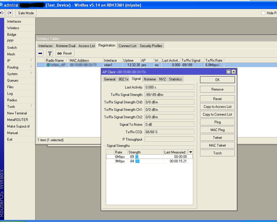

Using a Omni on a busy mast with sectors and Ptp’s all working below, 0-3db signal to noise, RX/TX signal 84 to 90db, and yet the link has stayed up for 13:30 hrs so far before it was disconnecting after 15mins or less.

Quick test i maxed out the link with a bandwidth test traffic both directions and it reaches 2.9-3.3Mbit udp, ping test Min:20ms Avg:35ms Max:42ms, no traffic Avg is 14ms, will check jitter later
