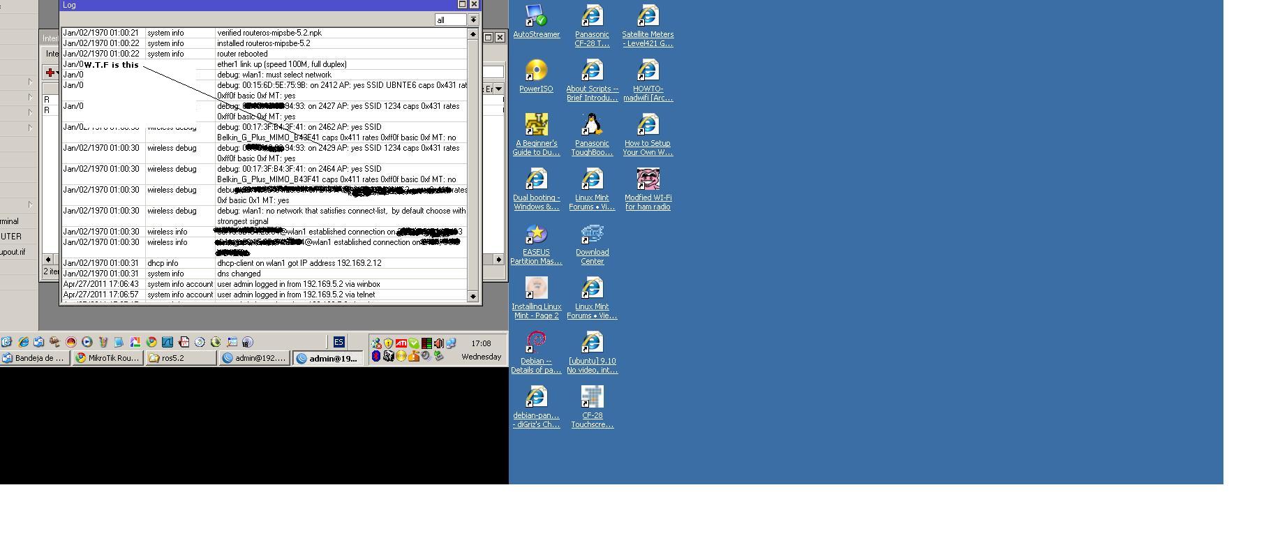

Well after a long chat with my pal Rudy last night, I was somewhat encouraged to give 5.1 a bash.
This morning, it was on MT site, this afternoon, it was replaced by ROS5.2… So biting hard down on a stick I fired it up.
Now please, what is this, some new frequency!!! 2429 Mhz… I hope that is not a pre-amble of what is to come.
Come on MT, I am scared enough to try any further ROS systems since 3.3 and 4.16, give me some confidence back!!!

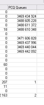

RB450G just upgraded to ROS 5.2, strange values in Queue Tree, column PCQ Queues:
Queues with these values are RED-type not PCQ-type.
On RB433AH everthing is OK.

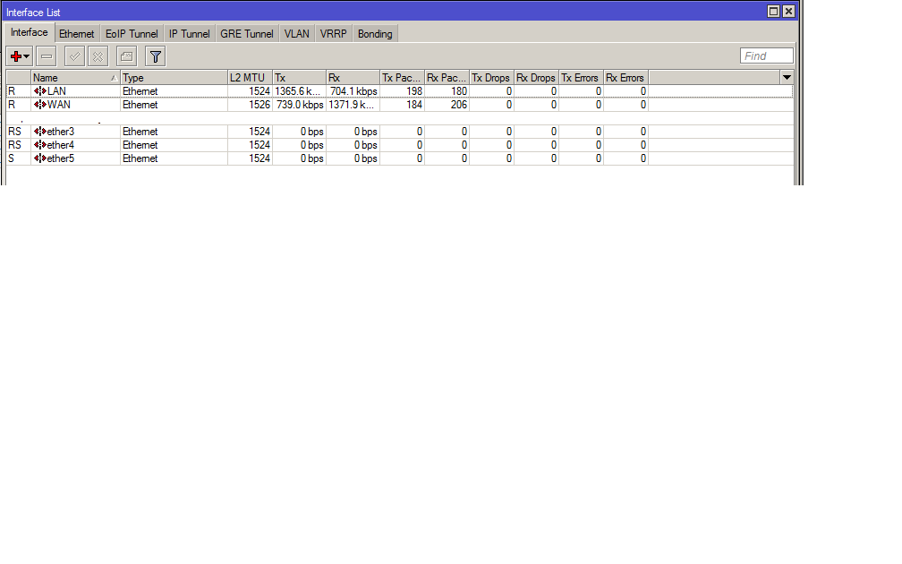

RB750, V5.2.
Cant see the stat of the “slave” interfases:
WAN - out interface
LAN - is the Master Port, all other slaves.
Is it Ok ?
Yes, switched traffic is not going though the CPU.
