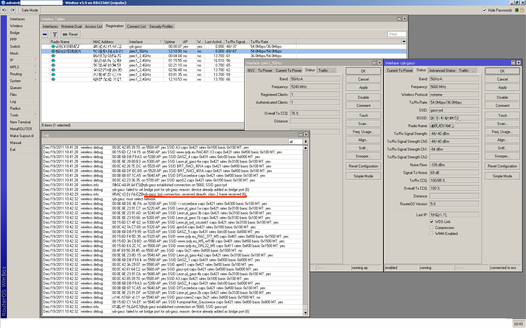

v5.9 got deauth: class 2 frame received(6)
Hello.
Link there for several years on the same hardware and previously there was no problem with it. Previously went to v3.30
I do not know whether that had an impact everywhere change to v5.9 or perhaps some other factor, but I get the message all the time only on the basis of a communication link in the WDS "received deauth: class 2 frame received (6).
As you can see the signal and the CCQ is very good, but despite this I get this message.
Frequency change is not important for incidence of Communication.
It can turn off or go on nstreme NV2?

Can someone tell me what is the reason? We have winter so fresnel zone can be excluded, because earlier in the summer occur only have this problem.
Does anyone know what is the reason? I see the topic was already discussed a few years ago mikrotik forum already, but nobody answered.
Maybe change this card on R52N ?
“receive deauth” means that the other end wanted to disconnect. I don’t know why, maybe bad signal, maybe some other reason.
-48/-40dBm bad signal? I don’t think so.
O yeaaa other reason like bad driver for CM9 or protocol nstreme or other ?
you have much too strong signal, this is just as bad as bad signal. reduce it to -55 or so. currently it’s like somebody is screaming in your ear until it starts to bleed :slight_smile:
also why you use nstreme? try nv2, it’s better.
You have right not signal but problem is nstreme in os v5.9.
NV2 TDMA=1, Cell Radius=10km - 2:11h and still now without any disconnection.
