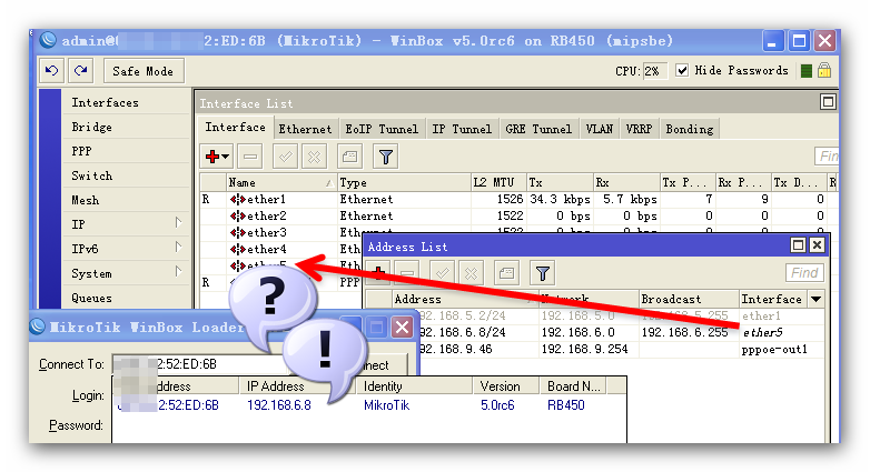

Double-click or left click the mouse is often considered a mobile command or select the move
try not to move the mouse while you are clicking :slight_smile: or find a better mouse. I have no such problems.
No, I do not think that is a mouse problem
V4 to no such case
However, this problem does not seem to rc6
Part of the problem still exists to modify dns
I don’t really understand the problem. Can you make video using for example http://camstudio.org/ ?
maybe this?
What are you referring to that part of the problem right?

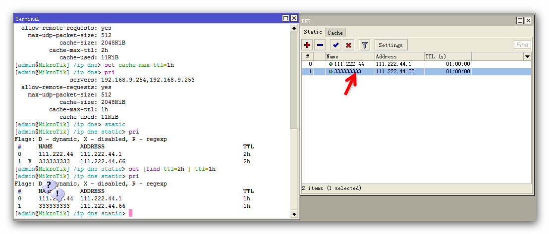

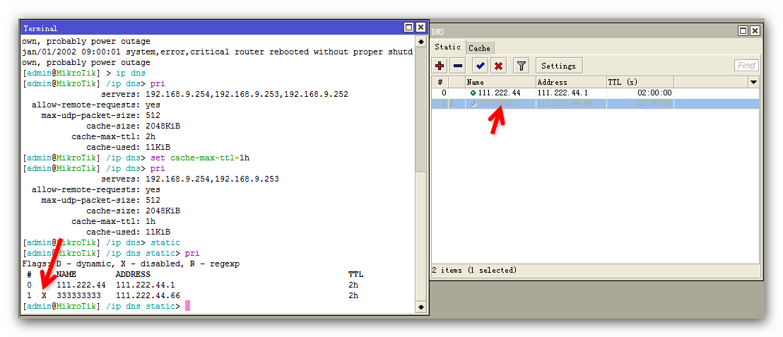

Any changes to modify the initialization occurred
I see that when you disable the entry in Winbox, it’s also disabled in Console. That’s normal. I don’t see any other issues in the pictures
Maybe /log print?
It outputs the information, what you have changed.

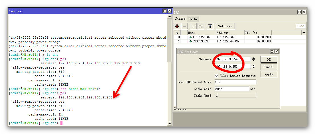

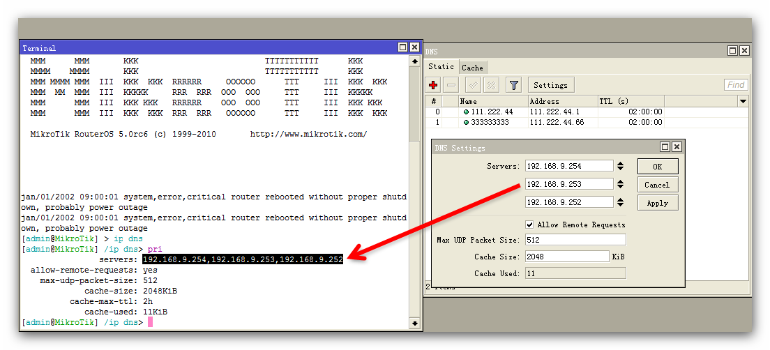

I explain
dns ip 3 before modification
Only 2 of the revised
But I did not modify the IP
dns static
I was disabled before the amendment
He was enabled, the modified
But I did not enable him

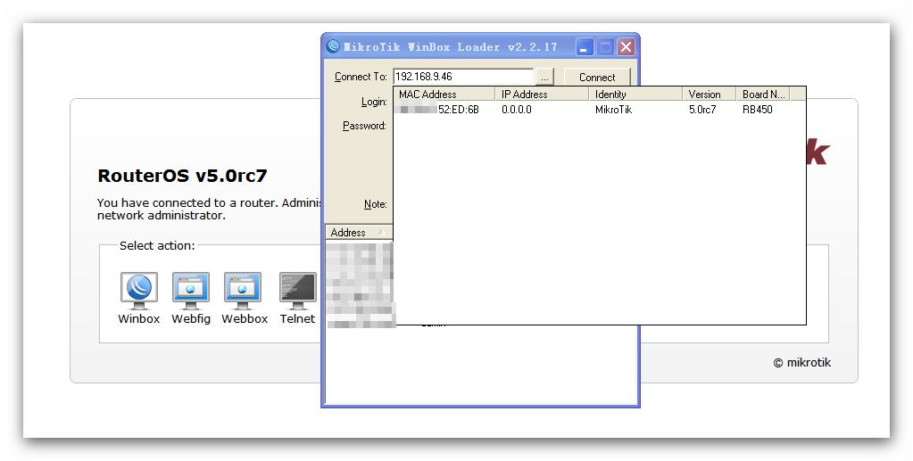

did you download the new winbox loader 2.2.18 from the router? i don’t have such problems
2.2.18 winbox?
