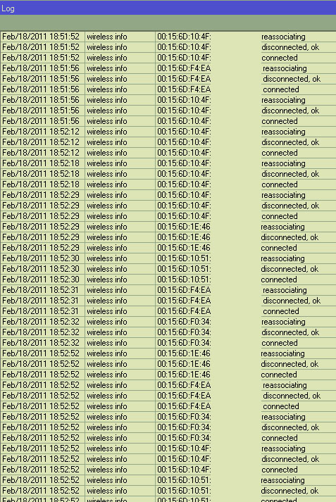

I don’t know if there is anything I can do to solve the disconnect problem:
I have other RB’s with other Radio like R52 and it’s working ok, but only with R52hn, I get all disconnect reconnect.
the only time i can stop these disconnects is if i manually enter values for “noise floor threshold” but then i will have some
users not being able to connect at all, and some other will connect but can’t surf, and some other will connect and surf but
with a very slow rate..
Could all these be the cause because I am using one chain on the R52Hn? I don’t know why why why…
