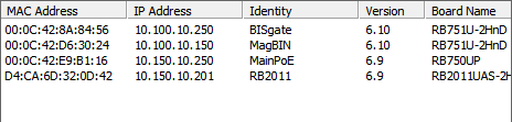

elmer, I’ve got very same problem with my RB/750 upgrading it to v6.10.
How do your hardware “work” exactly?
My RB/750 turns all LEDs ON (despite of real state of Ethernet ports) and no reaction in WinBox, no traffic at all (after normal reboot) – I’ve sniffed any packets with WireShark software.
If I reset device to defaults (short circuit contact hole with screwdriver or 1-2 sec RESET while powering on) hardware lights Ethernet LEDs right according to real port connections – but no any Ethernet packets too.
Finally I’ve tried to netinstall some versions 5.xx and 6.xx in hope to reanimate the device. Pressing RESET button untill ACT LED goes off gives device to network (IP, bootp, visible to netinstall) and makes netinstall process possible… but loading any firmware doesn’t repair my RB/750 after rebooting :frowning:
[Ticket#2014031166000717] support says:
unfortunately no, this model does not support it [RS-232]. It may have serial port pads on
pcd, but they won’t work without special software on router which we do not share
with public.
whole picture looks awflly like problem with nand flash on router, it could have
died of old age so to speek or just hardware failure of this specific chip. In
this case router hardware replacement will be required.
It’s strange that two RB751U-2HnD devices have been upgraded to 6.10 successfully and work OK for now.
Please get us to know about progress with yours (and details, please).
P.S. My RB/750 worked not hard in good datacenter conditions for ~ 2 years. Sad :frowning:

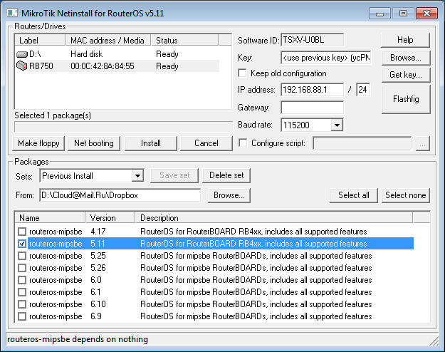

rextended, made all your checklist exactly (thanks for trick #4) twice with netinstall6.10+routeros6.10 & netinstall5.26+routeros5.26, but thats’ doesn’t help to repair my device.
After all, I can not see its MAC with WinBox in default boot mode (RESET button shortly pressed while power on) and free reboot.
Made one last try with [use SAME version of Netinstall and RouterOS!]
http://download.mikrotikindonesia.com/index.php?dir=Firmware/V5/routeros-5.11/&file=netinstall-5.11.zip
http://download.mikrotikindonesia.com/index.php?dir=Firmware/V5/routeros-5.11/&file=routeros-mipsbe-5.11.npk
Yes, that version!..
