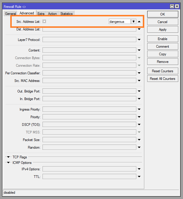

Good morning, after upgrade I see this - the select box is not full width in WinBox. It’s normal or bug? I didn’t see this in earlier versions.
