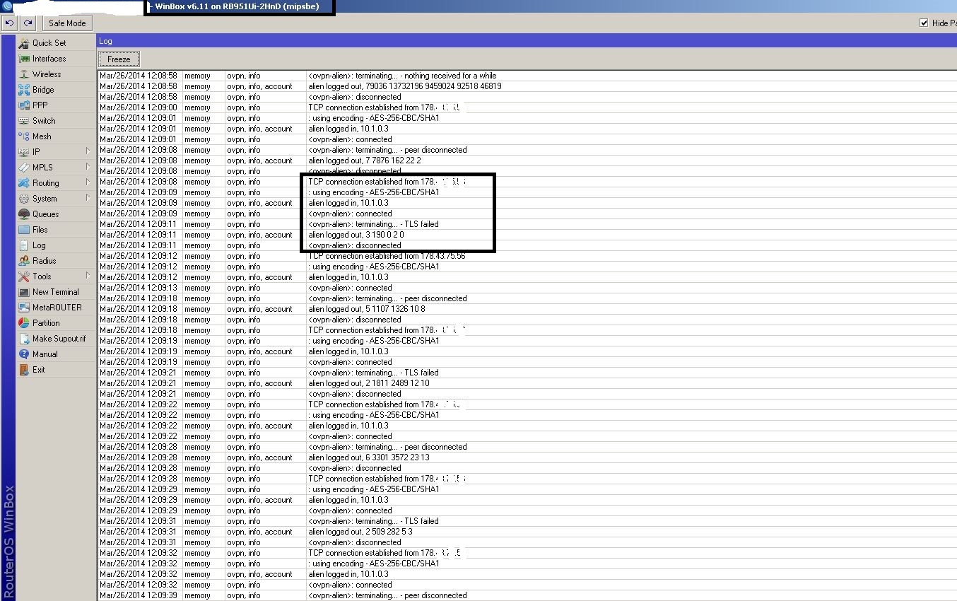

In 6.10 openvpn dont work good, 6.11 work very good but only one day, now i have this error.
