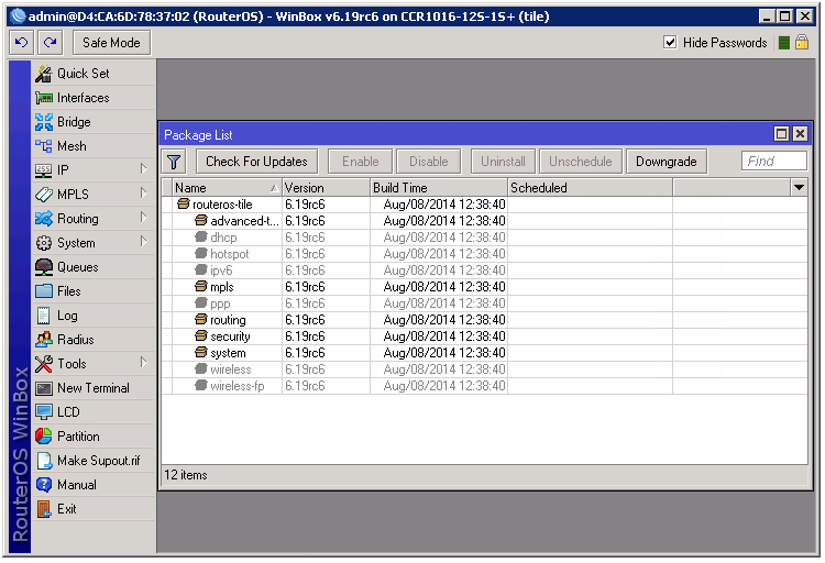

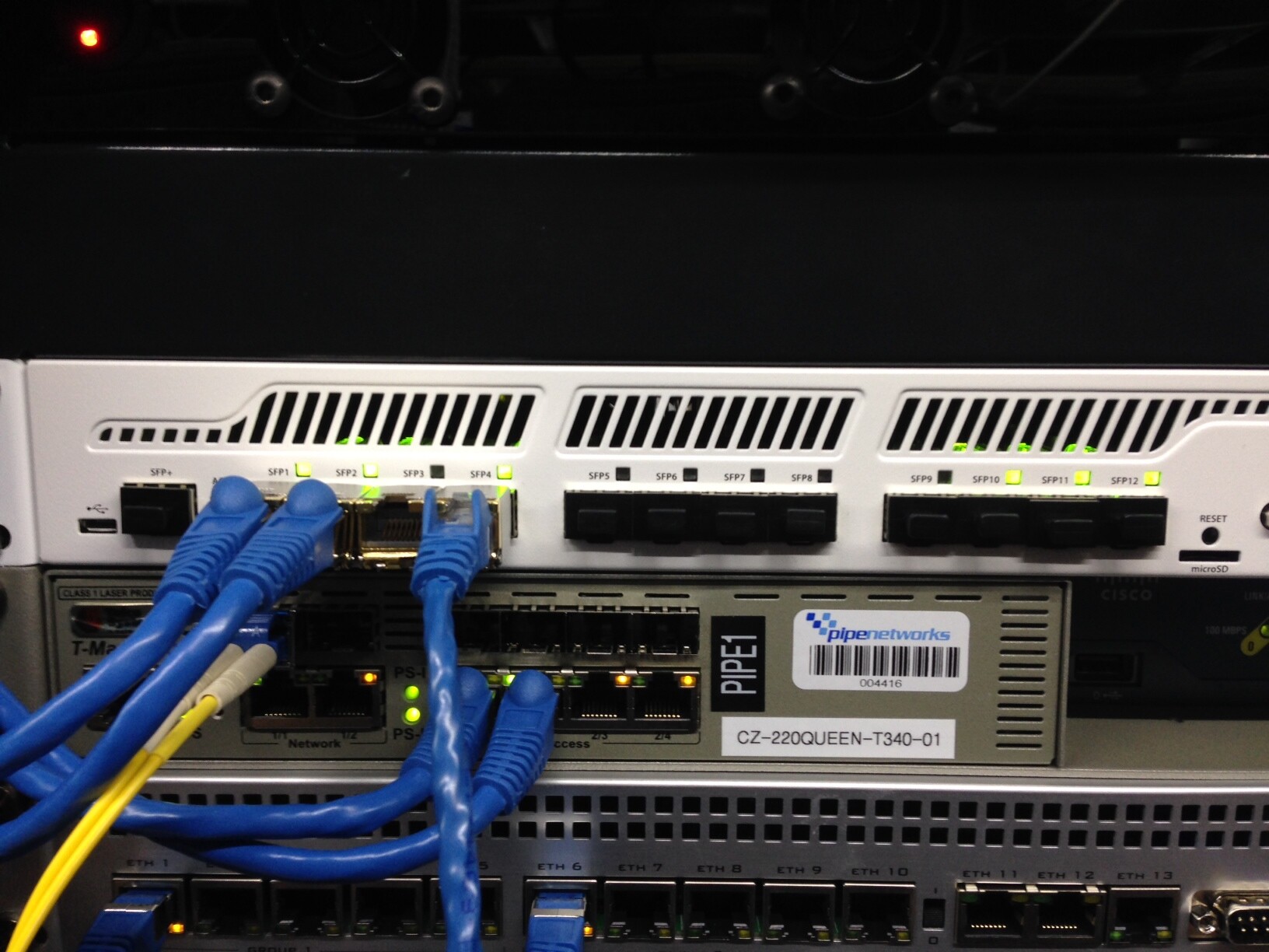

On CCR1016-12S-1S+ I set SFP1 & SFP2 to 9000 L2MTU, added a 802.3ad bonding interface, with interfaces SFP1 & SFP2 as slaves, then added a VLAN interface to bonding1.
The result is the VLAN interface (and bonding 1) will not pass traffic, and SFP10 / SFP11 / SFP12 interfaces light up / blink like there is traffic with nothing connected to them.
Also have a few packages I’m not using disabled.
