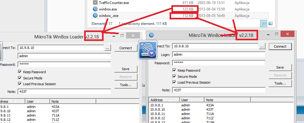

Now I’m just curious:
winbox from: http://ipaddres/winbox/winbox.exe
winbox from: mikrotik.com
Different sizes, same versions, why?
winbox from router will always be newer. I can’t comment on the size, maybe newer file was simply better compressed, but as features didn’t change, version number stayed the same
