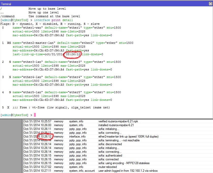

*) interfaces report last link up/down time and link down count;
Excellent addition. But it is visible only in terminal and the time shown does not account for timezone.

This is currently CLI only via “/interface print detail” and works for all interface types.
It will be in WinBox from 6.22
