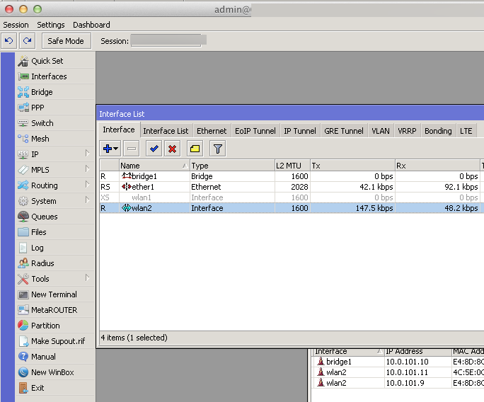

Confirmed issue is happening again, RouterBOARD SXT 5HacD 2n r2 no Wireless on main toolbar; wlan devices does indead appear on interfaces:
Ten minutes later, going to generate a supout, notice wireless button does appear back again. Not sure if related to ROS 6.36.3, Winbox 3.5, or the two combined?
