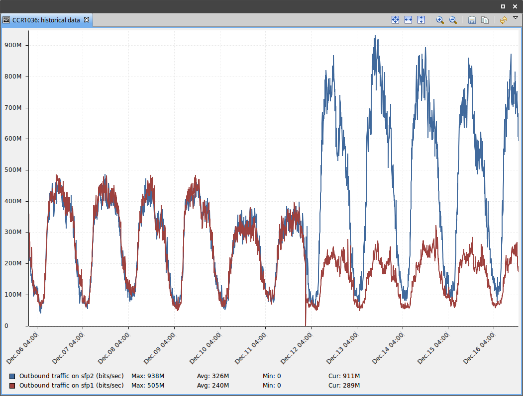

v6.36.4 problem with traffic balancing on bonding interface
After updating routeros traffic incorrectly balanced.

How to solve a problem?
What is the config at the other end?
