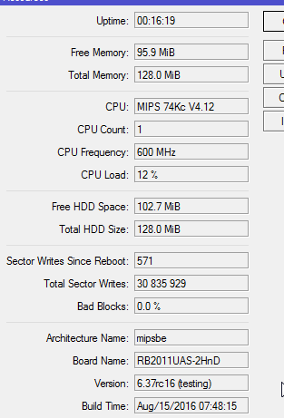

v6.37rc16 + ZTE MF823
Good day guys.

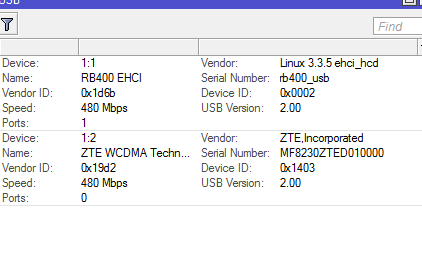

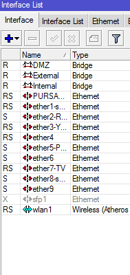

Today my main provider goes down. In hurry i bought ZTE MF823 and put in my RB2011UAS-2HnD

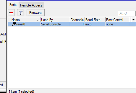

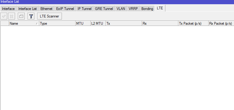

I cant place correct settings cause i dont have ZTE in LTE interfaces =(
Any hints?
p.s. just try RB751G-2HnD, all works fine with 6.36 stable.
2011 downgraded to 6.36 still no lte interfaces

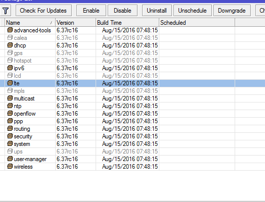

Additional screesns
First upgrade to a more recent version like 6.35.4 (6.36 is maybe a bit dangerous to try now)

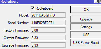

Also make sure you update the router firmware (that is not the RouterOS version!!) after you have installed it.
The version of the firmware should be something like 3.33
Firmware already 3.33
pe1chl, im very appreciate you help!! on flash i found 6.34.6 all works great. already downloading 6.35.4. THANK YOU!!
