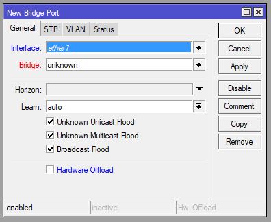

Hi, I have a question about new options for adding ports to the bridge
The documentation describes these parameters vaguely so I am asking you to confirm whether I think well
unknown-unicast-flood
selected - unknown unicast traffic that will come to this port is forwarded to all other bridge ports
no selected - unknown unicast traffic coming to this port is dropped
unknown-multicast-flood (if igmp-snooping=yes)
selected - unknown multicast traffic that will come to this port is forwarded to all other bridge ports
no selected - unknown multicast traffic coming to this port is dropped
broadcast-flood
selected - all broadcast traffic that will come to this port is forwarded to all other bridge ports
no selected - all broadcast traffic coming to this port is dropped
Thank you in advance for your help
In simple terms, yes, you assumptions are correct.
Updated the wiki to have more detailed explanation:
https://wiki.mikrotik.com/wiki/Manual:Interface/Bridge#Port_Settings
To be more specific, traffic is dropped when it should be sent out (egress), not when received (ingress).
