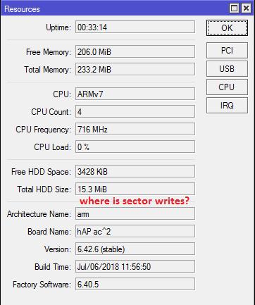

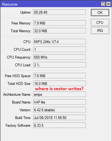

Where is the information on the write sectors?

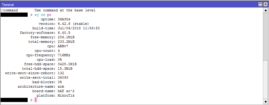

Previously, it was shown in WinBox, now only in the console:

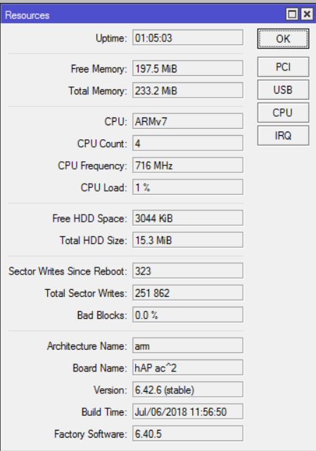

It’s strange. I have this information on my hAP ac^2.
AlexT - Have you accessed these device by direct IP connection or is it over, for example, RoMON? Can you try to clear cache on Winbox loader and connect again?
In my case sector write counters reappeared in Resources window after I reopened it in Winbox.

Clearing the winbox cache has not helped, but deleting files from %AppData%\Roaming\Mikrotik\Winbox - helped.

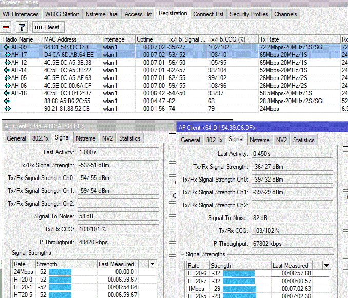

Don’t know if this is 6.42.6 related but it struck my eye after the upgrade:
We have now CCQ rates better then 100%!!! That is good! But impossible imho.
Also, on a 2,4Ghz AP most CPE’s (mikrotik and 3rd party) connect with 1 chain only where there is ample difference in signal over the both chains… how come? This was never the case!
