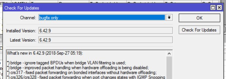

What is unknown string string “bugfix”? :slight_smile: Where string “long term”?
