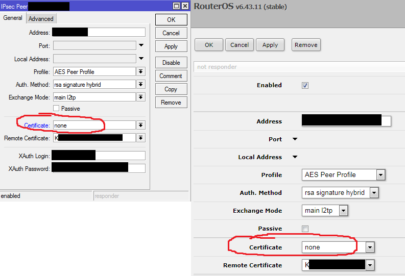

IPsec settings are not saved and are reset. If you open through winbox when you log in IPsec - > Peers in one of the settings, the certificate settings are reset and does not save. I change the settings and then after a while they are reset again. when opened in winbox, it shines blue as if I had changed something, but I did not change anything. This is a bug, fix it Please!
