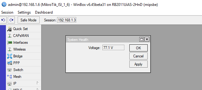

V6.45 on RB2011 /system health
Hye
i have un big problem with /system health , the voltage is 77.1V and i can´t the temperature
and this script (2 years old) with schedule not work and is very important for spring/ summer in my office
/system health
:if ([get temperature]>54) do={/tool e-mail send to="info@xxxxxxx"  subject=("[MK_6]High temperature WARNING :  ". [/system identity get name]. " Router ") body=("High temperature. Current temperature in Celsius : ".[/system health get temperature])} else {:log info ("temperature is ok.".[/system health get temperature])}
:if ([get temperature]>59) do={/tool e-mail send to="topex_61@xxxxx" subject="+34647xxxxxxx" body=([/system identity get name]." # "."temperature : ".[/system health get temperature]." # ".[/system clock get date]." # ".[/system clock get time])}
Thanks for your help
Please create a supout file and send it to support.
http://forum.mikrotik.com/t/problem-with-mount-point/94/1
If you experience version related issues, then please send supout file from your router to > support@mikrotik.com> . File must be generated while router is not working as expected or after crash.
Also it’s not recommended to run beta software on critical devices since bugs are to be expected.
