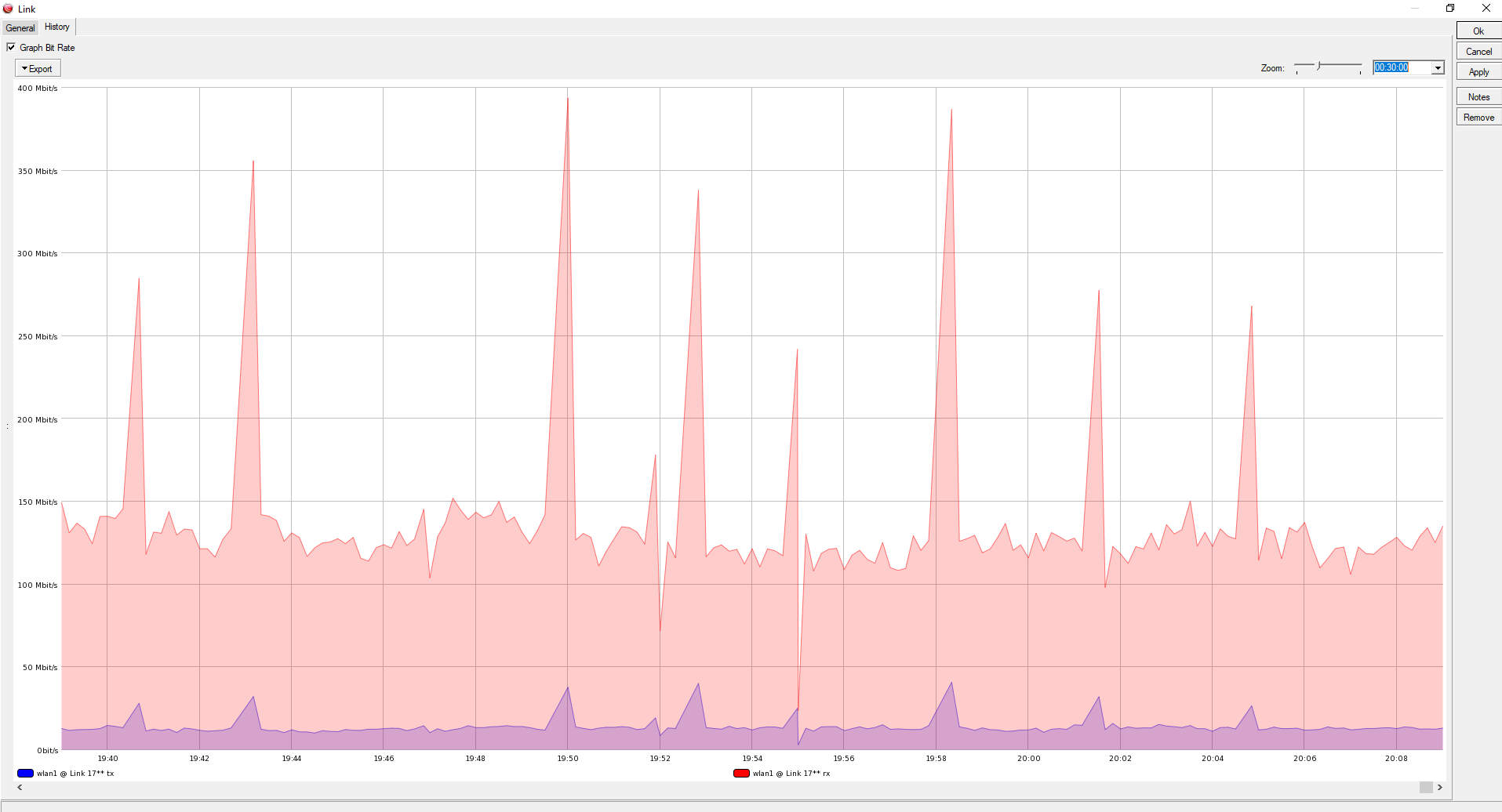

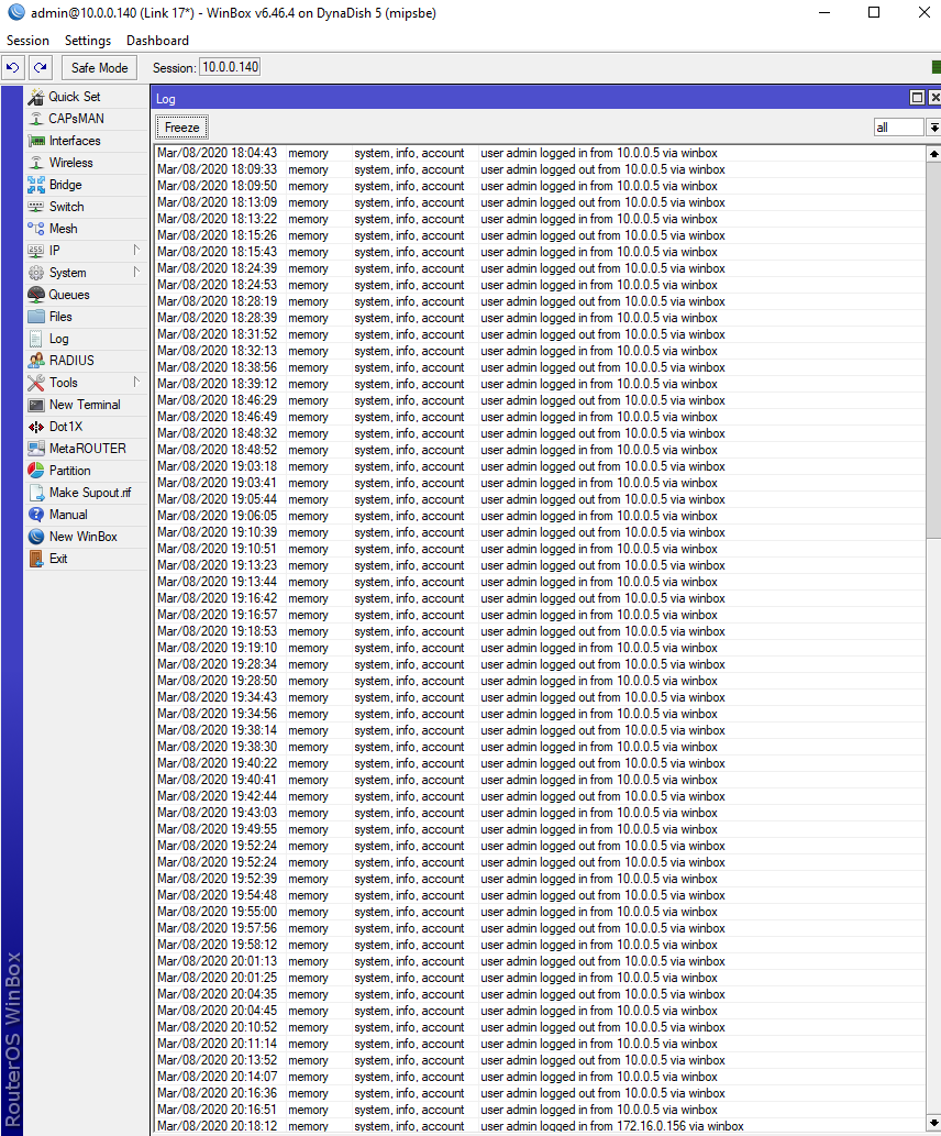

New problems with 6.46.4. All information that is removed through the ROS is distorted. For example, on graphs of loading of interfaces of jumping 2-3 times bigger than real. Also, the pipe is constantly connected to the equipment … See screenshots…
What is the % CPU usage on your DynaDish? This graph looks symptomatic of the metering process periodically missing interval deadlines and then making up for the missed data in the next interval.
