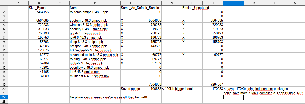

as the “bundle” ls LZMA’ed together, the compression algorithm is more efficient than when compressing the packages independently
the final effect is that if you try to install the same packages as the bundle, but independently, you use more flash space.
(i made an excell sheet to quantify that…)
Mikrotik really should come up with a “lean bundle” NPK, without MPLS/Hotspot/Routing, that really have no place in SOHO.
