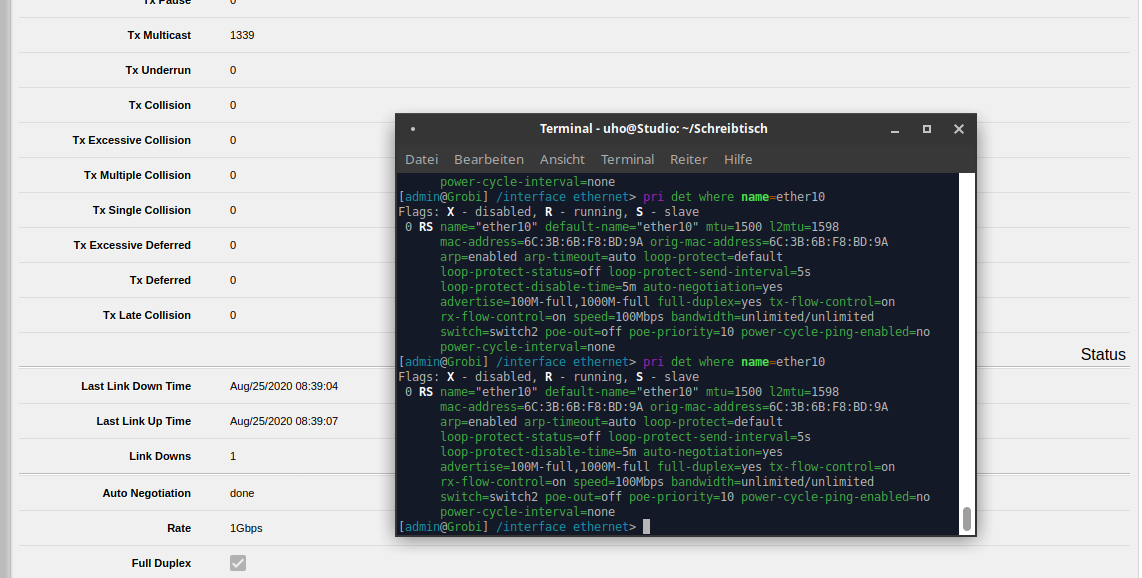

Status now: Link somewhat works but link setup is unclear as different modes are reported (yes, I can’t believe that myself):
CSS326 webif: autonego on, 1G, full duplex, flow control on
RB3011 webif: autonego on, 1G, full duplex, flow (RX&TX) control on
RB3011 console: autonego on, 100M, full duplex, flow (RX&TX) control on
Take it as a warning and wait for an explanation first!
At least make sure you can powercycle your remote devices! (Not reboot but powercycle=plu-out-plug-in)
Actual link state in ROS is displayed using command /interface ethernet monitor ether10 once. With print you don’t really get actual interface state, you only get actual config … and speed=100Mbps in that printout is setting withich would have been applied if auto-negotiation was set to no (which it isn’t).

Hi Metod,
thank you for coming back with that. With the hint you gave, I see
[admin@Grobi] /interface ethernet> monitor ether10 once
                    status: link-ok
          auto-negotiation: done
                      rate: 1Gbps
               full-duplex: yes
           tx-flow-control: yes
           rx-flow-control: yes
               advertising: 10M-half,10M-full,100M-half,100M-full,1000M-half,1000M-full
  link-partner-advertising: 10M-half,10M-full,100M-half,100M-full,1000M-half,1000M-full
That is then in line with the webif and makes perfect sense then. Thank you for that important hint.
