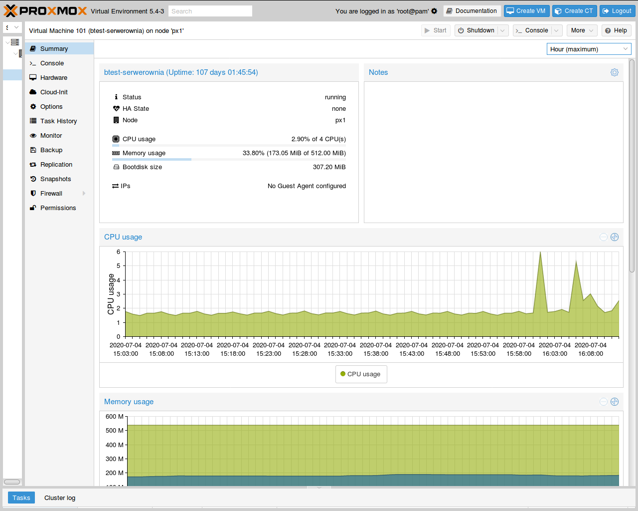

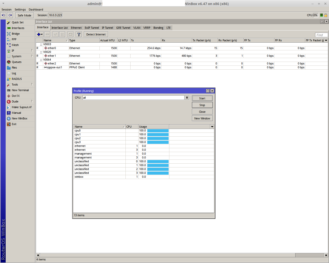

/tool profile cpu=all
show 100% cpu usage on all cores in x86 vm on proxmox 5.4-3
Upgrade was done at 16:00.

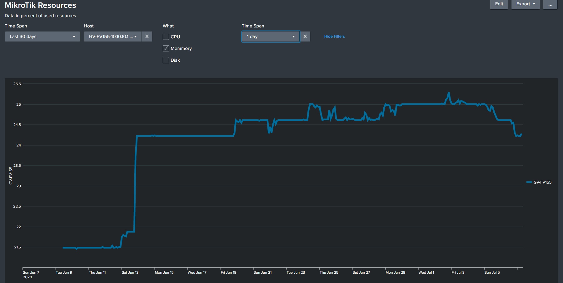

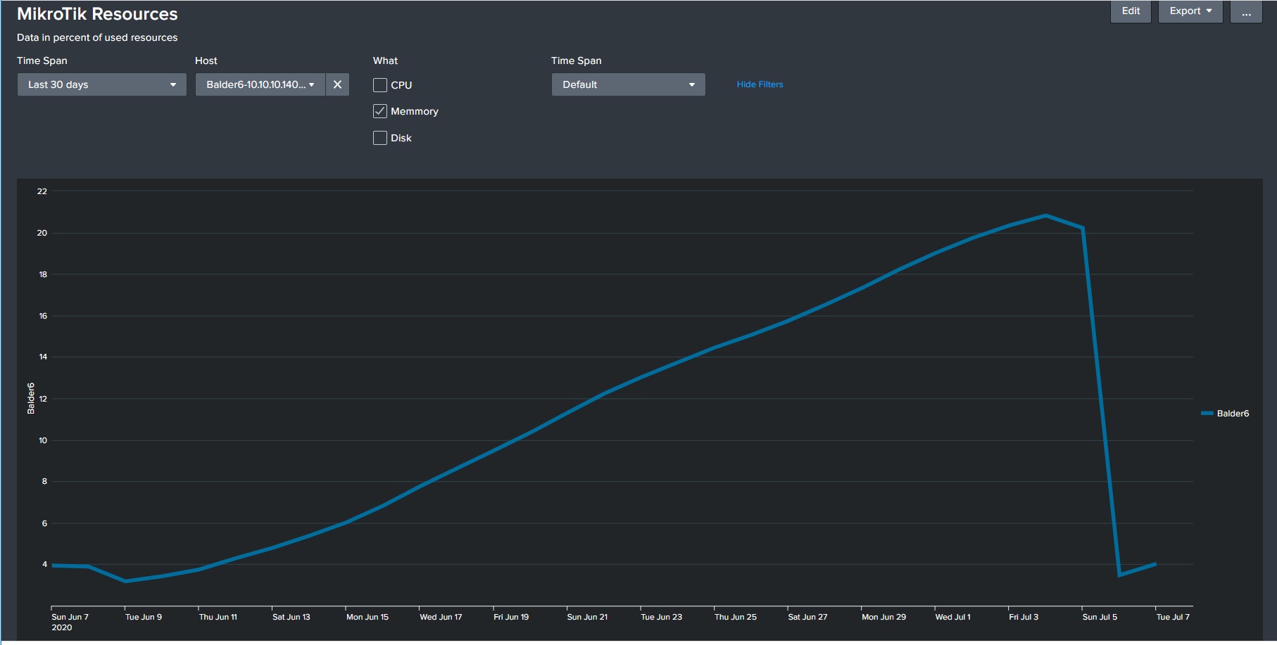

After activating the DNS over https, a memory leak occurs. Here are the graph data from the monitoring system. Router Model RBD52G-5HacD2HnD
@itforeverru
It looks like you are inn to some. Here is memory usage on MT 6.47 (running on a vmware)
This router only do DoH and used for testing only.
A reboot was done 5 July
My RB750Gv3 that is much more loaded, does not show this behaviour. 6.45.9
