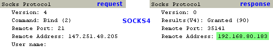

There’s problem with SOCKS’s bind command. It’s supposed to return external address to which someone else can connect (e.g. if client wants to use active FTP with PORT command). Old SOCKS4 work correctly, it returns WAN address (192.168.80.183 in this example):

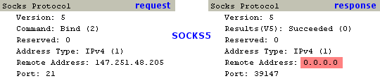

But new SOCKS5 doesn’t:
