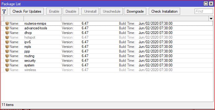

msatter Do you have custom set of packages installed and wireless package is not installed?
I also lost direct Winbox access to my 4011RM which is behind the the hEX-S and now only able to connect through Romon. The configuration did not change and Winbox just flashes by on my screen. For the safety I revered to 6.47 on my hEX-S.
Update.
The TikAPP can access the 4011 directly without problem. Really strange!
Update:
Ignoring the saved VIW file gives access again and I hope that this will not happen again and I have to make backups of those VIW files in case of that.
Correct. My system has system, dhcp, advanced-tools & security installed. Opened SUP-21264 with support output.

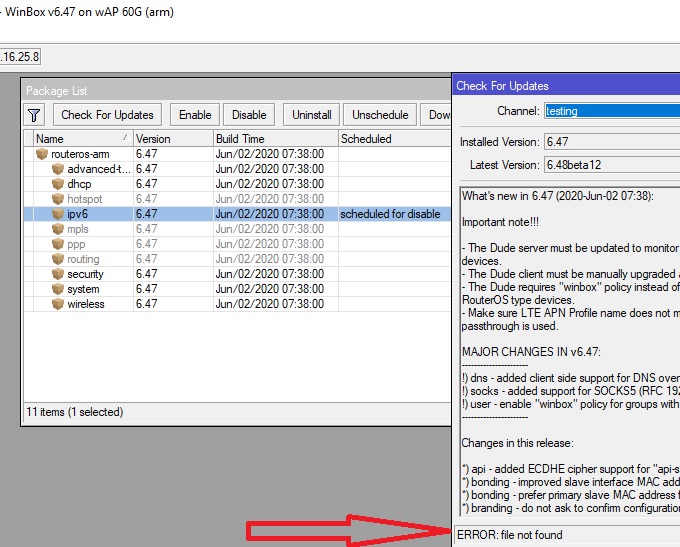

On ARM: Check for updates: ERROR: file not found

Not only on ARM. They probably withdrew the build due to the problems mentioned above.
I had that same message on my hEX-S, so I manually uploaded the firmware file.
@nkourtzis: It happened even before any reports were made so not likely that the files have been removed.
