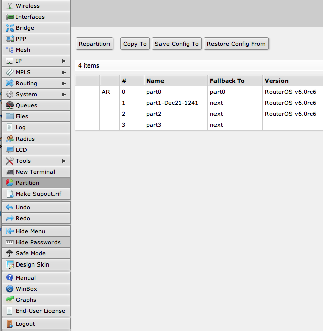

There is partition in winbox, my rb1200 64MiB…what for that feature?
I recommend you to try the new Partition feature, if your router has enough NAND space.
Manual: http://wiki.mikrotik.com/wiki/Manual:Partitions
Yes agreed, partitioning is very cool, manual is here:

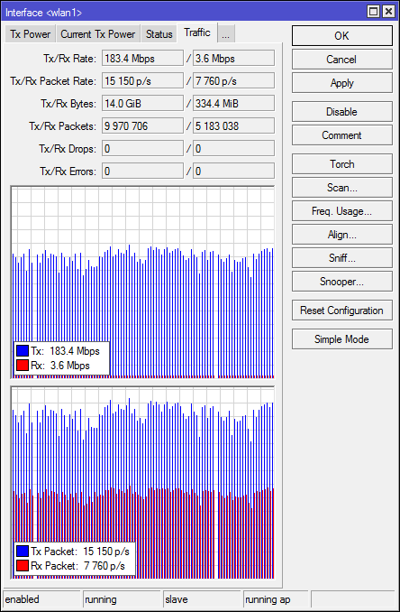

Guys, a couple of releases ago access point mode was slow and dodgy.. It seems that with the latest releases all works fine.
Attached a screenie of the throughput on a RB493G with 2 pigtail antenna’s connected to a r52hn card. Client is a Dell laptop with an Intel wifi link 5100 copying some files across SMB..
Very nice now.. Peaks at 23’ish MB/s via Wireless.
THANKS. Keep up the good work.
