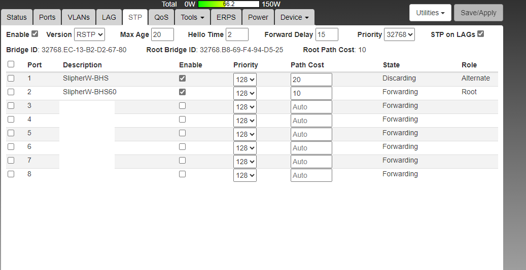

To accomplish this I setup the Netonix with RSTP in the below configuration.

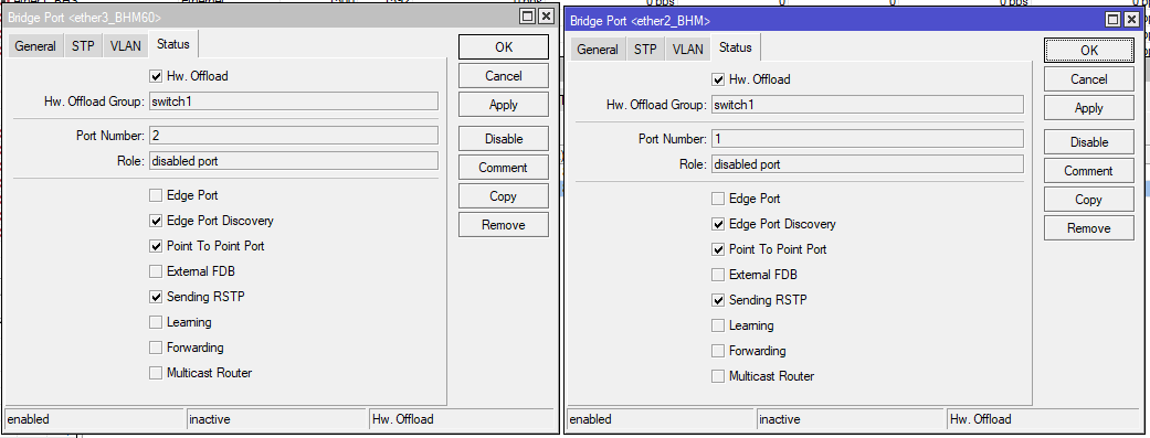

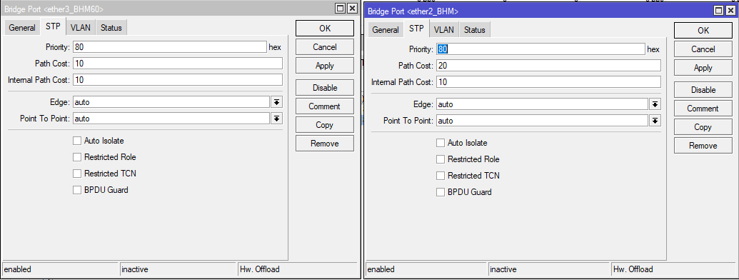

On the router side at the feed tower I have the following setup.

When I logged into the Netonix switch at the other tower instead of the ports being like the photo in post 1 they were both in a Forwarding State and both had the Root Role. Again if I unplugged one of the ethernet cables on the router side all traffic on the router stopped forwarding.

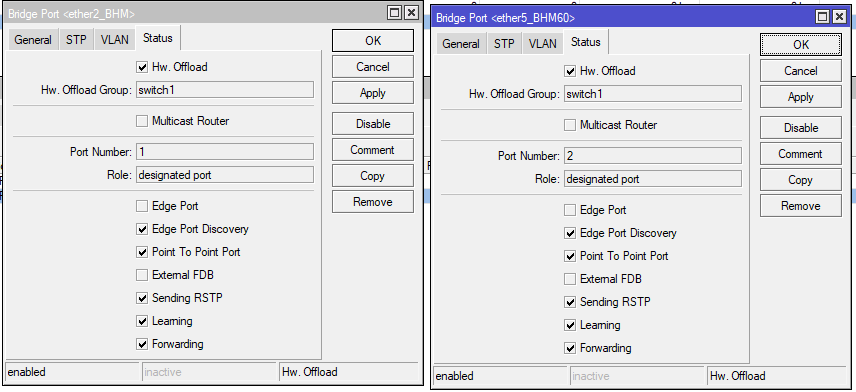

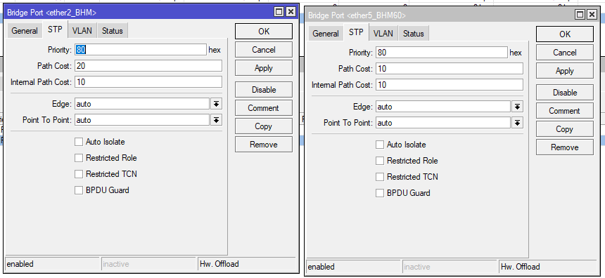

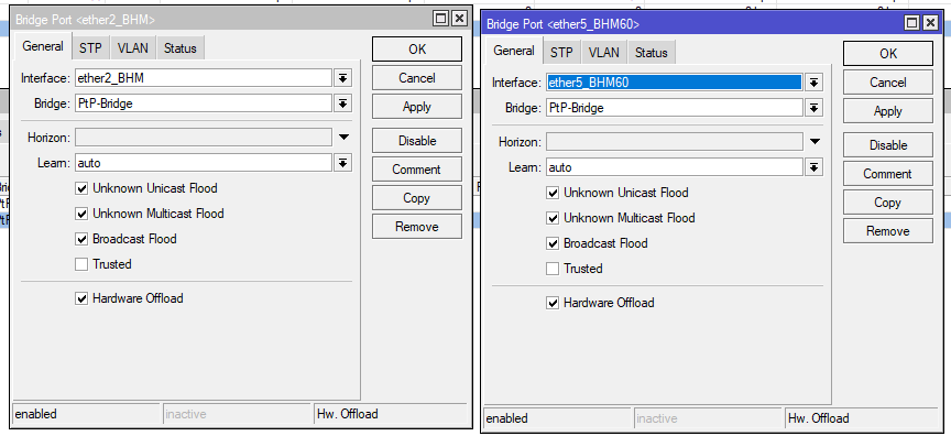

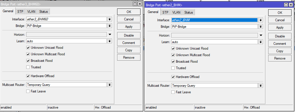

Did I do something wrong with my configuration, or should I be doing this setup another way? See photos below for how I have the RB4011 setup. These are photos with the RB4011 on the bench connected to nothing.
I guess to summarize I want to have two PtP wireless links work in an active/failover setup where one tower only has a switch (Netonix) and the other side has a router. Right now it works with the router side running V6, but that could be do to dumb luck and not because I have it configured properly because when the router is instead V7 it does not work as intended.
