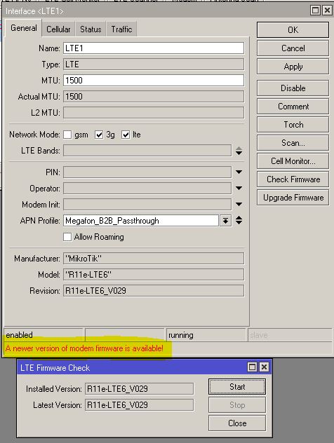

Still cannot upgrade the modem firmware to R11eL_v05.04.193841 on my LtAP mini LTE US-Kit. Once you want to upgrade, the LTE lost connection to internet.
