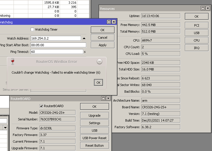

CRS326-24G-2S+
could not enable Watchdog
upgraded from rc6
tried from Winbox and from CLI
