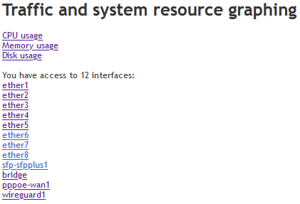

Can confirm that http://10.10.10.225/graphs/ only gives one line with:
Traffic and system resource graphing
Send an email to support@mikrotik.com and report the problem.
You can use SNMP or Syslog to get CPU to an external server.
Here is a graph from Splunk for MikroTik, se link in my signature. http://forum.mikrotik.com/t/tool-using-splunk-to-analyse-mikrotik-logs-4-0-graphing-everything/153043/1
Here it works OK! I get 3 lines for resources (CPU, memory and disk) plus 33 lines for my interface graphs.
Users are allowed to hawk their third-party wares in the official forum? Doesn’t feel like good security practice.
It’s user forum (not official support forum) and no, generally propaganda posts are not tolerated unless such posts adds value to discussion. Which post in particular do you find disturbing?
He’s referring to Splunk post above probably, but that’s nothing (doesn’t ask for money or something, it’s just a guide on how to use the service and the script required to do so) compared to other users advertising their shady business all over the forum (posts, topics, signatures, images linked to own webserver etc). But if MikroTik is OK with it, why should we care.

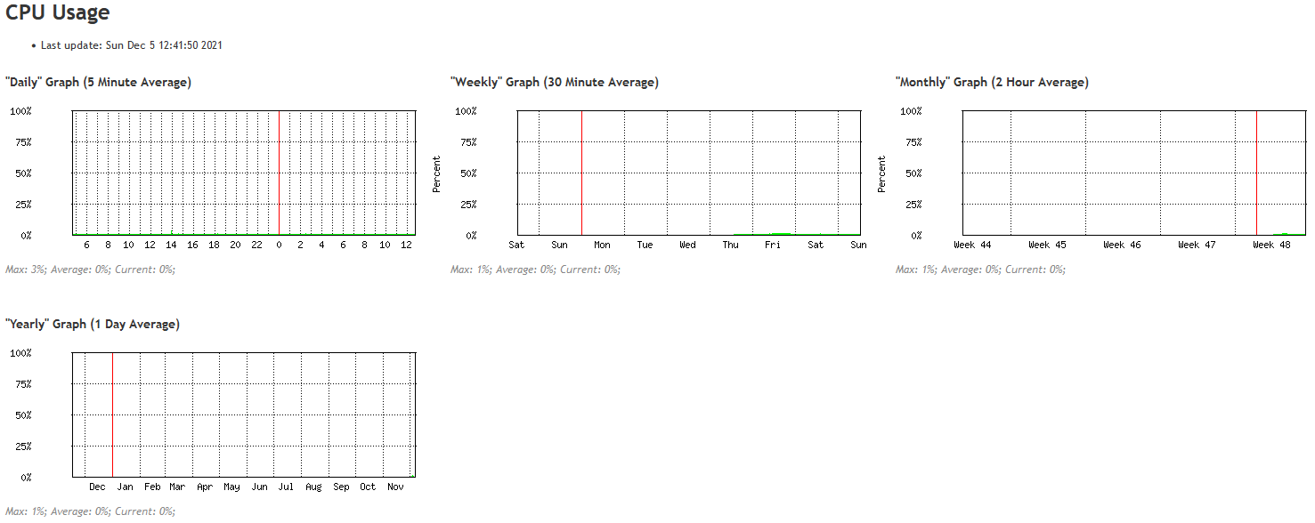

PS: Graphing seems fine on RB5009 / arm64
Yes, it’s not doing much currently.
