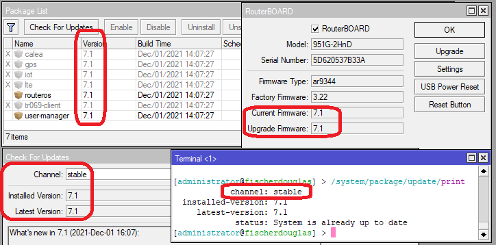

Today I Finally decided to use unicorn version 7 of RouterOS on a production environment.
Wich one? My house!
Better to suffer the possible mishaps of an update on your own network than be cursed by consulting clients discovering “little details” in their production networks.
A different version of the phrase “Eat your own dog food.”
As you can see on the prints, I’m using “Stable” channel with v7.1 od RouterOS and v7.1 of Routerboard Firmware.

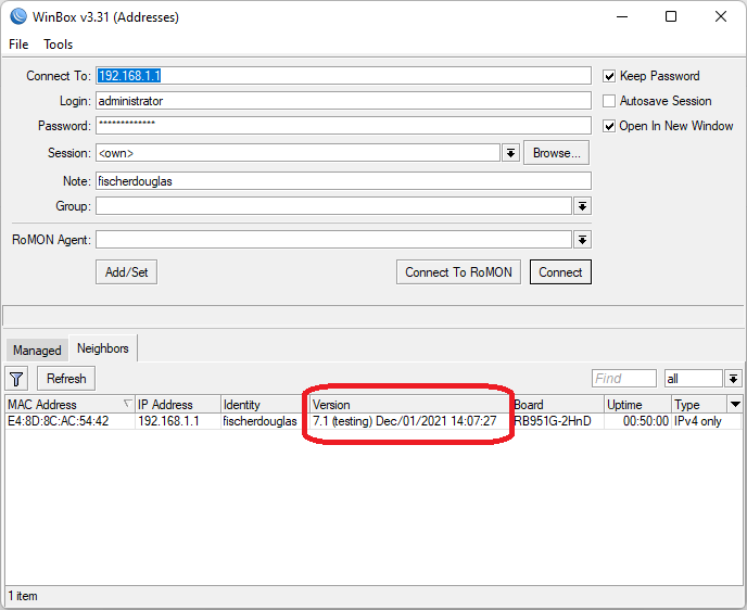

But RouterOS is propagating “(Testing)” on its Mikrotik Neighbor Discovery Protocol Announcements.
Is just a Cosmetic Bug!
I Won’t affect anybody’s network performance…
But brings a suggestion of the string of “Version” in MNDP be composed of multiple variables in the environment.

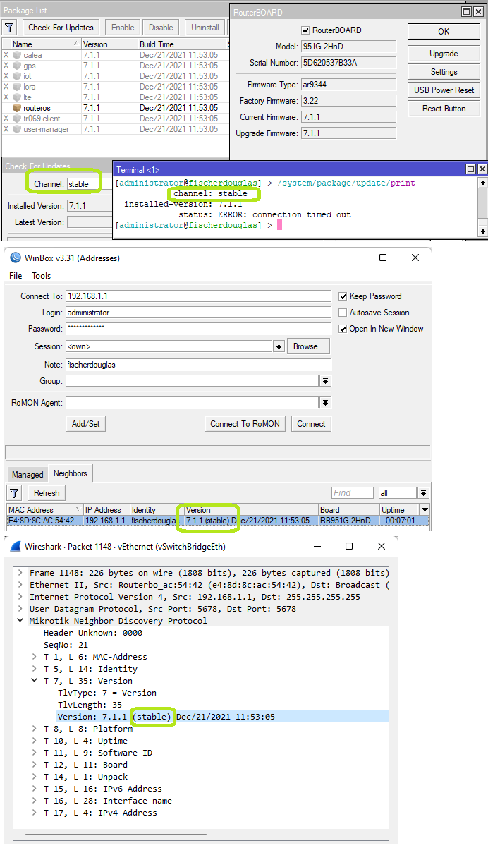

P.S.: I also used Wireshark to check if there wasn’t any mistakes of buffers…
It’s not a bug. Webpage release system is not the same as RouterOS build system. If we decide to promote a version to another channel, it requires a rebuild, which seemed like not crucial just for this
So, are you saying that those that choose “stable” channel are actually using “testing” version?
What about an infographic diagram of version paths to clear the doubts?
There are two branches v6 and v7.
Each of them has their own channels, if there is v7 “testing”, “stable” or whatever, it does not replace versions in v6 channels.
There is only one released v7 version (7.1), so it basically fills all the channels of v7 branch until newer version is built for specific channel.

Hey Guys.
As I said, IT WAS A BUG!
A cosmetic bug, but it was a bug.
And it has been fixed…
Thank you!
