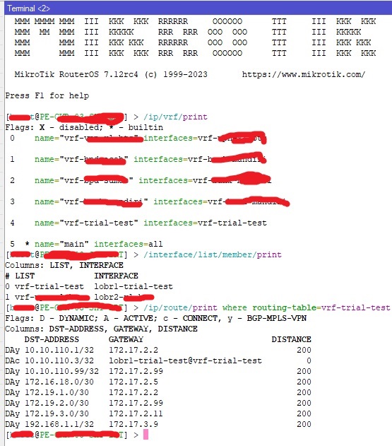

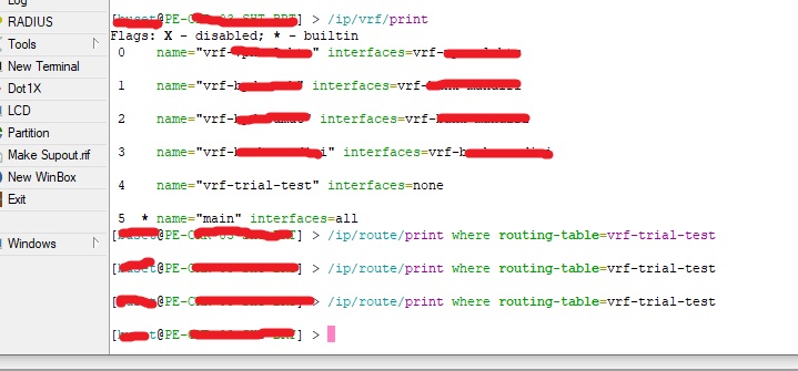

Dear Mrz,
please take a look this attachment.
this is when interfaces set to loopback
and this when i set interfaces-list into "none
thx
