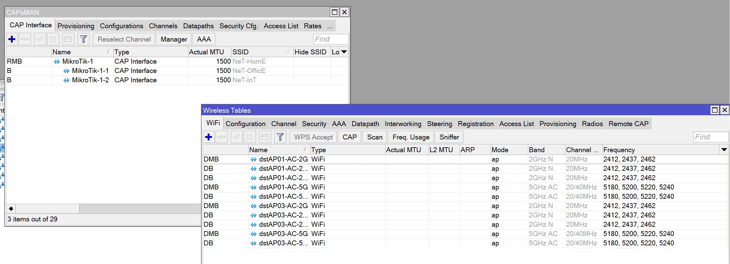

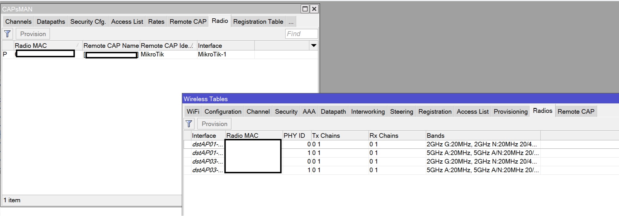

Today I moved both cAP AC and hAP AC2 to the new wifi-qcom-ac-7.13-arm package and setup them as CAP with the new CAPsMAN (the one under /wifi/interface) however I have an issue.
If access points get rebooted all works fine, after power cycle the CAPs come back, but in case the RB5009 is rebooted then CAPs are not showing up in remote CAP tab. The only way to bring them back is to disable and re-enable CAPsMAN.
To mitigate the issue I added a script to do an off/on of CAPSman at each startup but I wonder if this is a something wrong with my configuration or a bug.
I don’t have use cases with RouterOS < 7.13 because until now my AP couldn’t get wave2 drivers so until now I used only the old CAPsMAN so I cannot tell if this is something happenning also with previous version and I cannot downgrade to test otherwise I cannot use the new wave2 drivers.
Is someone facing the same issue?
**** EDIT - PROBLEM SOLVED ****
I found that this behaviour happens if the CAPs are setup to reach the CAPsMAN using a fixed IP address put in “CAPsMAN address” parameter instead of using discovery interface. I put a fixed IP in my early test from wireless to wifi package and I left the configuration like that as I didn’t imagine to have a side effect. Now I moved back to discovery interface and after the reboot of the CAPsMAN the remote CAP are showing up without any problem.

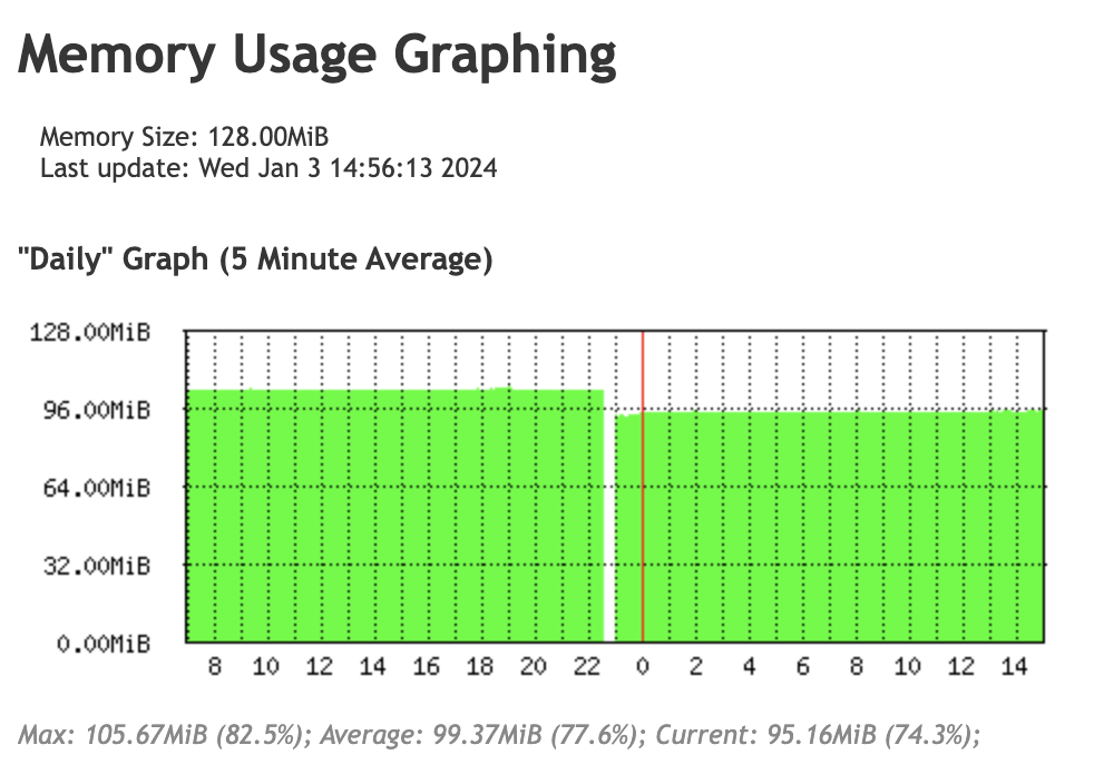

This night I had another
system,error,critical router was rebooted without proper shutdown, probably kernel failure
system,error,critical kernel failure in previous boot
system,error,critical out of memory condition was detected
And Graphing looks innocent:
Hey MikroTik, is it worth sending autosupout to support?..
Always a good idea!
What device are you using and how is it configured?
And for how long was it up?

cAP ac, about 2 weeks uptime (first one rebooted with ~9 days uptime?..)
Will try to send a mail to support, thanks :slight_smile:

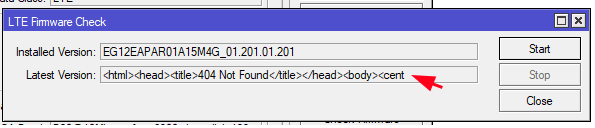

Issue spotted with D53G-5HacD2HnD (Chateau LTE 12)
Two things happened with v7.13
Noticed new LTE firmware, downloaded it, and installed firmware, blue led light turned pink, periodically ended up intermittently flashing pink on and off.
Waited for few minutes then rebooted device, it came back up with blue led light on at a constant.
Navigated into Interfaces > LTE, clicked on lte interface and check firmware
Posted supout.rif - SUP-139367
