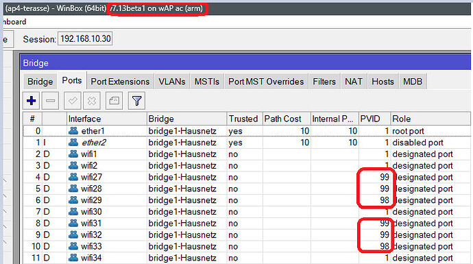

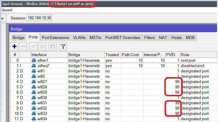

Updated Hap ac2.
Thanks for the reply, but I don´t understand what that exactly means? Maybe you can explain?
All VLANS are configured in the CAPsMAN only via “Configuration → Datapath” and it seems to work:
It´s working with all my CAP AX devices in the same manner (all 7.12). Actually it looks like a “cosmetic” error only…but I will test the VLAN functionallity on the AC device later…
