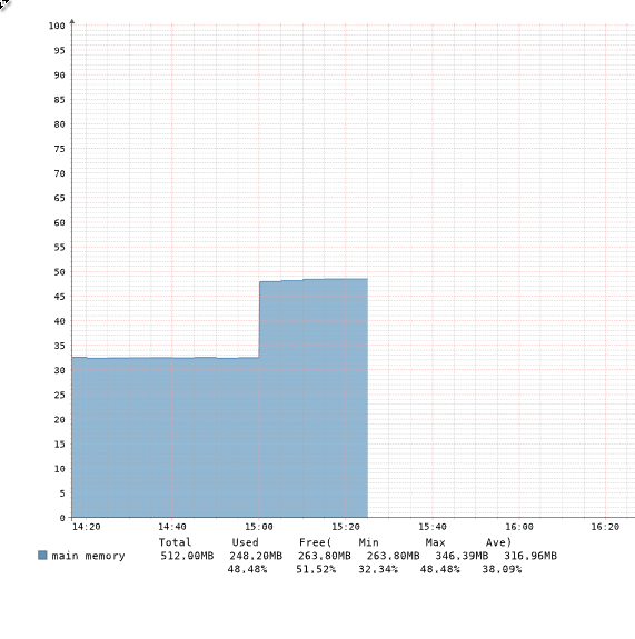

woooa
CHR, 7.14.3 → 7.15
free memory decreased significantly

woooa
CHR, 7.14.3 → 7.15

woooa
CHR, 7.14.3 → 7.15
Probably cause of:
*) x86/chr - improved panic saving (increased minimal RAM requirements to 256MB);

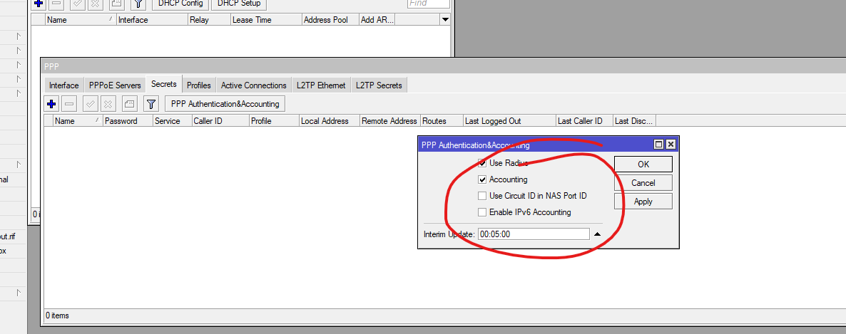

*) ppp - added “enable-ipv6-accounting” option under PPP AAA menu (CLI only);
But i can see the Enable IPv6 Accounting Option in Winbox itself…

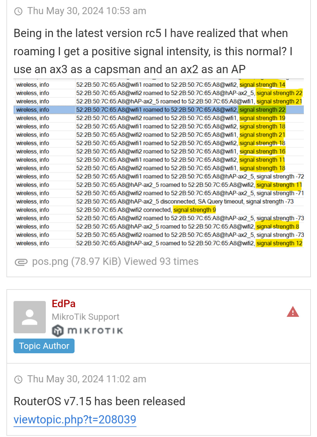

08:87:C7:54:87:F8@wifi1 associated, signal strength 37
08:87:C7:54:87:F8@wifi1 connected, signal strength 37
1C:57:DC:6C:C6:BA@wifi1 associated, signal strength 59
1C:57:DC:6C:C6:BA@wifi1 connected, signal strength 59
in the log the signal strength is greater than zero, but should be less.

This problem was still in beta version
The wifi driver in the new ROS does not display the connection signal level correctly.

another one:
https://forum.mikrotik.com/viewtopic.php?t=206877&start=300#p1077877
I also have positive signal strenghts issue and roaming is messed up, multiple devices randomly roam from 5ghz to 2ghz 1-2m from ap under full signal(below -40 db ) and then hang on 2ghz, which makes no sense and never had such issues on prev versions.
