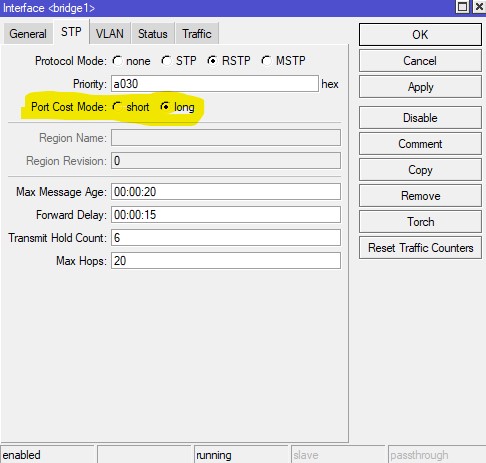

Can any one Explain what dose this option do?
Found this in V7.15.2
If is set it to Long what will happen
and what will happen if i set it to short.
Manual is still not updated.
Short mode is 16 bits and long mode is 32 bits for path cost. The same mode needs to be set on all switches in the network to function.
I found it for you.
https://help.mikrotik.com/docs/display/ROS/Bridging+and+Switching#:~:text=port%2Dcost%2Dmode%C2%A0(long%20%7C%20short%3B%20Default%3A%C2%A0long)
Note that this is a complete mess if you got a multivendor environment and want to use STP:
https://www.cisco.com/c/en/us/td/docs/switches/lan/catalyst4000/8-2glx/configuration/guide/spantree.html
The IEEE 802.1D specification assigns 16-bit (short) default port cost values to each port that is based on bandwidth. You can also manually assign port costs between 1-65535. The 16-bit values are only used for ports that have not been specifically configured for port cost.
802.1t assigns 32-bit (long) default port cost values to each port using a formula that is based on the port bandwidth. You can also manually assign port costs between 1-200,000,000. The formula for obtaining default 32-bit port costs is to divide the bandwidth of the port by 200,000,000.
Along with that for example Cisco IOS up to version 16.03.069 the default were short but since 16.0.6.x the default is long.
So make sure that the portcost is manually set to either short or long (were long is the prefered if all your devices supports this).
Thank you so much for quick response
