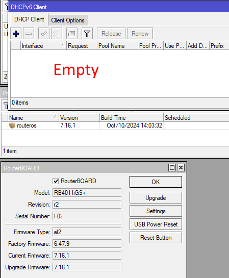

I have enabled dhcpv6 client via terminal and now every command that I do inside ipv6/dhcp-client hangs or times out. Notice the “#error exporting “/ipv6/dhcp-client” (timeout)” in the middle of the text:
[xxx@MikroTik8] /ipv6> export
2024-11-23 00:53:51 by RouterOS 7.16.1
software id = 3GZX-TBTL
model = CRS112-8P-4S
serial number = F14F0EFCA324
/ipv6 nd
set [ find default=yes ] disabled=yes mtu=1492 ra-preference=high retransmit-interval=3s
/ipv6 settings
set accept-redirects=no accept-router-advertisements=yes forward=no max-neighbor-entries=8096
I don’t see the DHCPv6 client record in WinBox but when I try to add one, it complains “dhcp-client on that interface already exists”.
I even tried to restart the router multiple times.
How can I fix this? How can I remove the dhcpv6 client that is not being shown anywhere?

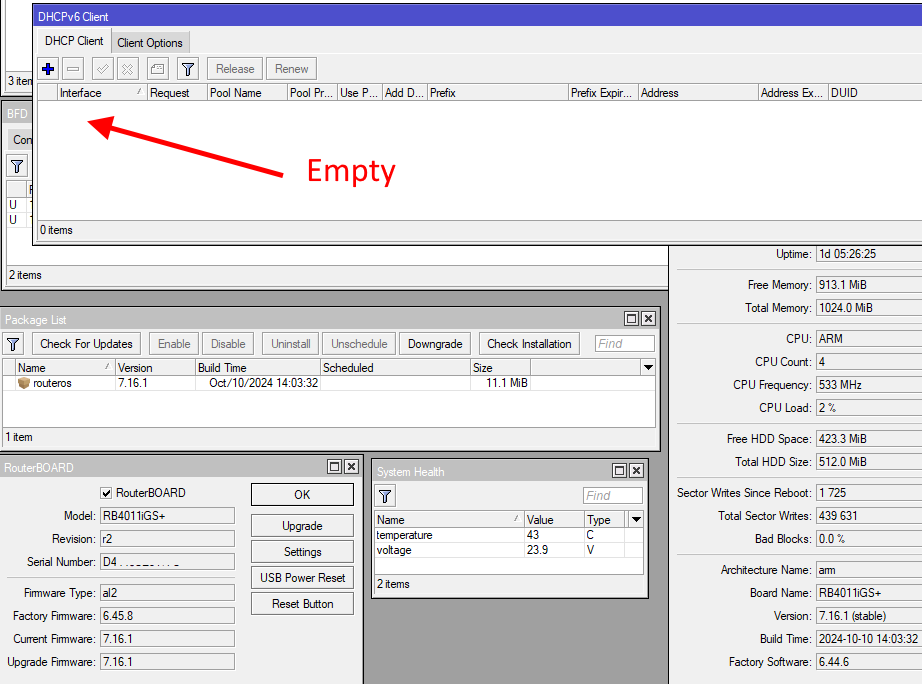

There’s been some kind of confusing situation. It doesn’t make any sense. I have two 4011s with firmware 7.16.1 that were fine a week ago. Today I noticed that DHCPv6 client on both devices stopped working normally. I have not made any changes to the settings. Everything “really” broke on its own.
/ipv6 address
# address pool error: pool not found: ipv6-triolan (4)
add eui-64=yes from-pool=ipv6-triolan interface=bridge1
#error exporting "/ipv6/dhcp-client" (timeout)
In the backup from the previous weekend, these lines looked like this:
/ipv6 address add address=::2ec8:1bff:feae:493d eui-64=yes from-pool=ipv6-triolan interface=bridge1
/ipv6 dhcp-client add add-default-route=yes interface=sfp-sfpplus1 pool-name=ipv6-triolan rapid-commit=no request=prefix script=":if (\$\"pd-valid\" = 1) do={\r\
    \n  /ipv6 firewall address-list remove [find list=allowed]\r\
    \n  :delay 1s\r\
    \n  /ipv6 firewall address-list add address=\$\"pd-prefix\" comment=\"!!! Check YOUR pool from ISP\" list=allowed\r\
    \n  /ipv6 firewall address-list add address=fe80::/16 list=allowed\r\
    \n  /ipv6 firewall address-list add address=ff02::/16 comment=multicast list=allowed\r\
    \n  :delay 1s\r\
    \n} \r\
    \n" use-interface-duid=yes use-peer-dns=no
Did devices reboot in between by any chance?
Yes, both devices rebooted during this period.
By the way, noticed a similar problem on another 4011. This is the third one.
I had a similar problem on version 7.16. Completely different location, but also on 4011. The solution was to downgrade ROS to 7.15.3, disable and delete all IPv6 settings, upgrade ROS to 7.16 and configure IPv6 again. I tried the same steps (ROS downgrade, etc.) on these three routers. However, it did not work. I cannot re-configure IPv6.
I would like to point out, that I have only observed a similar problem with 4011. The routers are located in neighboring houses in a cottage village. In the building, where the village security is located - hAP ac3, in the building next to it - CCR1016-12G. And no problems with IPv6.

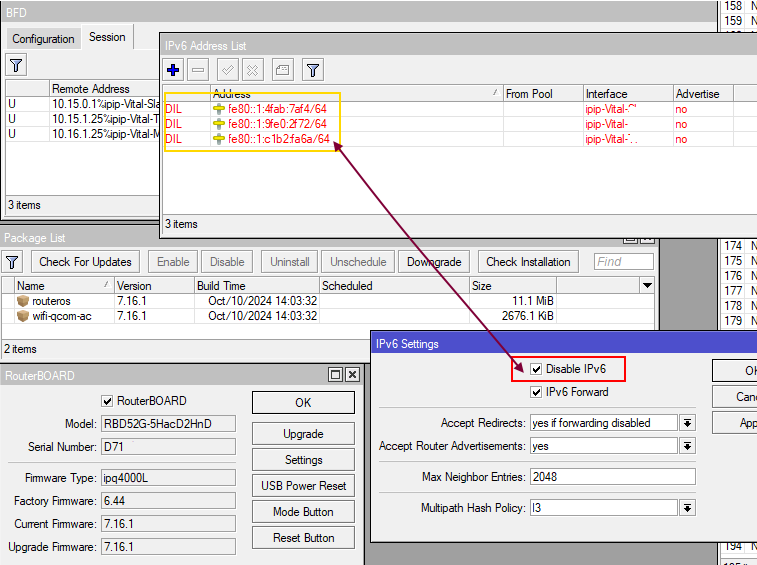

And one more question. I have routers, that do not use IPv6 at all. Why do such devices assign an internal IPv6 address to IPIP tunnels? The use of the protocol is disabled, the addresses are invalid.
