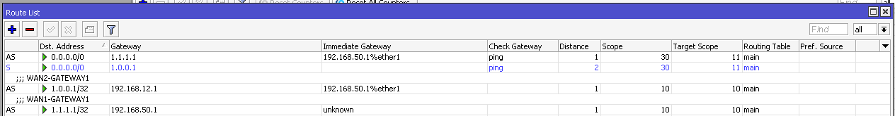

Do recursive route no longer show up red when they are unavailable and inactive? Previous releases (can’t remember how long ago), but they would show red when they were not active. Closing the route window and opening it back up does not change it.

You are doing that wrong! You should have the /32 routes with “ping” check and the recursive 0.0.0.0/0 routes without “ping”.
I’ve tried both ways, but this way actually let’s me have two DNS checks for each WAN route. I’ve tested it thoroughly. If 1.1.1.1 is unreachable, but 208.67.220.220 is, it keeps the route for WAN1 active. Only if both are unreachable, does it disable the 0.0.0.0/0 route for WAN1.
Same thing for WAN2, it has 2 DNS server checks: 1.0.0.1 and 208.67.222.222.

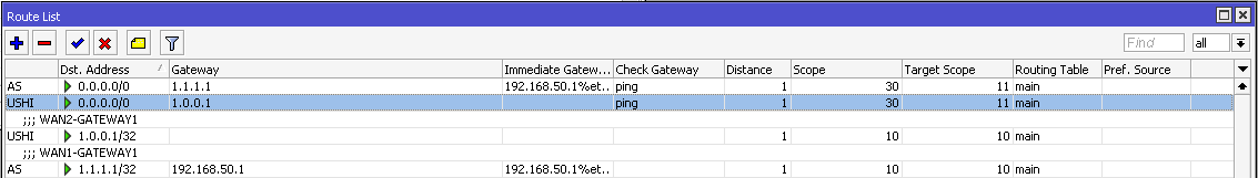

I realized my screenshot doesn’t show all the routes. See below.

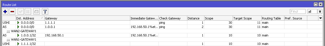

Here is another example, more simple. WAN1 is disconnected and the 0.0.0.0/0 route with distance 1 is Unavailable and Inactive, however it does not show red or any clear indication that it’s not the active route.
0.0.0.0/0 with distance 2 (WAN2) is the active one.
have you hit F5 or closed / reopened the ip/route window? The routing table doesn’t get updated in realtime anymore since the release of ROS7. It’s incredibly annoying, for all non-bgp users with less than <1000 routes in the routing table.

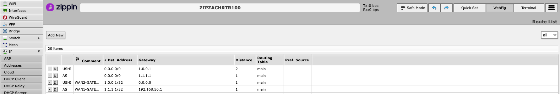

Yes, I’ve tried closing the route window, opening it back up, closing Winbox, opening it back up. It doesn’t refresh nor show red anymore. I’ve also tried on Webfig, but it shows the same as Winbox.
It will show blue if WAN2 is up, but WAN1 is active (as WAN2 has a higher distance).
ehm.. I didn’t notice that before, but it seems that the check gateway functionality is completely broken in 7.16.
See the packet counter for 1.1.1.1 in the raw table..
It’s not turning red for me either, but the failover works.
But, I agree, if you‘re used to have non-working routes marked red, it can be confusing. Don‘t know if this change is intended or a bug, it has definitely worked in earlier versions of ROS7.
