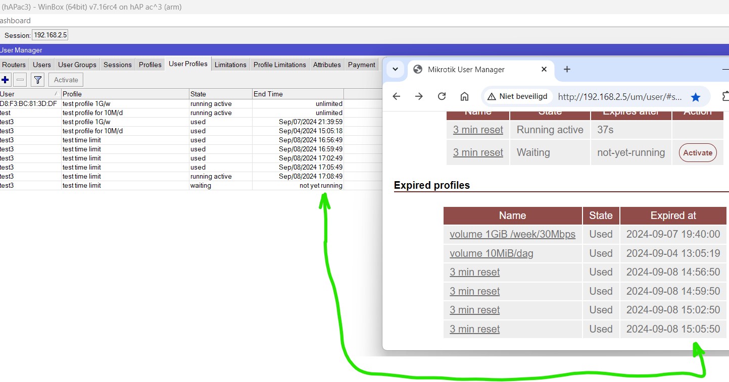

Probably not new to this release, but at least it is still there. User Manager things.
- Terminating EAP wifi sessions by User manager doesn’t work (NAK received from NAS , error cause in the packet = 605 = not implemented)
- Many “UM NAS rebooted” messages (with but sometimes also without any reboot of the AP (=NAS), what triggers even much more disconnect attemps by UM with NAK responses
- Trying to limit wifi EAP session time, to stop the NAK loop, …
— with UM Attribute "Session Timeout " fails to be triggered (Attribute is set in User Group)
— Idem for the “Session Limit” parameter in the limitation. Assigned to user via User → User Profiles → Profile → Profile Limitations → Limitations
Only thing that is triggered and works is the validity set in Profiles.
While testing the failover to the next “User Profile” , the information to the user is missing the GMT Offset correction. (GMT time shown?)

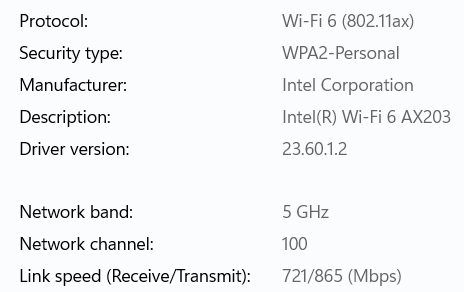

I am facing Wi-Fi connection issues with my hAP ax3, causing the laptop to disconnect during Zoom meetings. As you can see in the logs the laptop gets disconnected from AP despite having the strong signal. This happened in the recent stable version (7.15.3) and still happens in the latest rc version.
The laptop has an Intel(R) Wi-Fi 6 AX203 adapter, and the version of the driver is 23.60.1.2. Anything I can do to fix it myself?
So far the only solution for me was temporarily replacing hAP ax3 with my old hAP ac2 running wifi-qcom-ac drivers, which works pretty well.

Another observation is the network adapter does not always select the latest and greatest AX standard with the WPA3 security type. It often favors the AC standard over AX.
Current solution is rollback to 7.14.3
Disable WPA3…
I’m using the latest driver as of posting and here’s my uptime for my ax210 WPA2 only.
netsh wlan show drivers
Interface name: WiFi
Driver : Intel(R) Wi-Fi 6E AX210 160MHz
Vendor : Intel Corporation
Provider : Intel
Date : 24/07/2024
Version : 23.70.2.3
INF file : oem27.inf
Type : Native Wi-Fi Driver
I’m using same version 23.70.2.3 adapter is AX201
Thanks everyone! I’ve disabled WPA3 for now.
