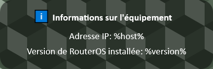

mhh… i have an issue since 7.17, percent variables in branding maker doesn’t transform anymore, leading my branded skins like this:

The %version% and %host% variables are deprecated and are no longer supported.
Sorry for the inconvenience caused.
https://help.mikrotik.com/docs/spaces/ROS/pages/69664784/Branding
