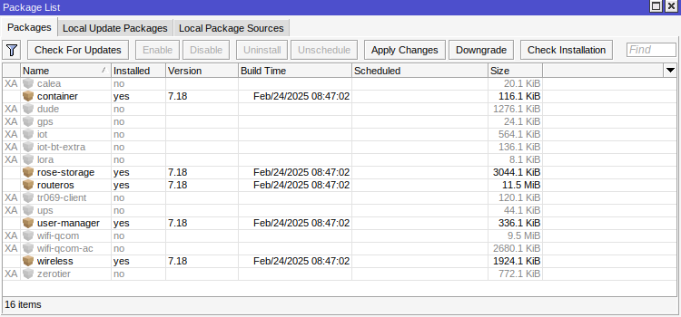

I saw exactly the same on hap ac, 600 kb left after that. Even uninstalled packages came back after resetting the router and the reason Is I got locked by no rules. First rule in the FW filter list to filter incoming dhcp-offers disappeared somewhere. It was fine until I simplified some Address Lists (combined them) using WInBox.
They forgot to test again, I suppose.
UPD: Now router rejects offers from netinstall to flash long-term back. Nice piece of software.
PLEASE PLEASE PLEASE study the matter before you claim that packages get installed.
Starting from 7.18, this list has both the packages that are installed, and those that are optional to install.
Besides marking for uninstall, was the device rebooted to complete uninstall @nipfel?
And did you create supout to inform support?
This is not really constructive.
Can’t imagine people overseeing such a thing, can you?
Well, I have often commented that the changelog is inadequate and should be replaced with something that has more info, links to documentation, etc.
But when looking at the packages screen, I really do not see how someone could think that packages are installed that are not:
