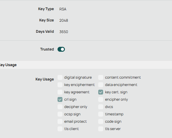

Updated to 7.19, one IPSEC channel is not establishing anymore — “can’t verify peer’s certificate from store”.
UPD: turning off and turning on again “Trust” status on certificates helped to solve this problem.

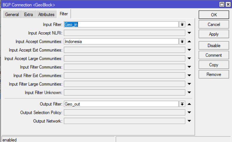

*) bgp - fixed input.accept-community;
at last, no more using input accept NLRI hack again lol

My central point was upgraded. After the upgrade it cut all OpenVPN clients (other Mikrotiks) because there seems to be some problem with a certificate. What to do now? Hopefully I don’t need to touch all the clients… the CA cert should be still valid, it is self-signed. I think this was caused by adding the built-in CA feature.
debug: <195.168.229.239>: disconnected <TLS error: ssl: no trusted CA certificate found (6)>
Solution: Guys really watch out, if you are upgrading remotely, this will just cut you off if you are using certificates. Disabling and enabling “Trusted” works, but this seems like a nasty bug. I was lucky my router has 4G backup.
