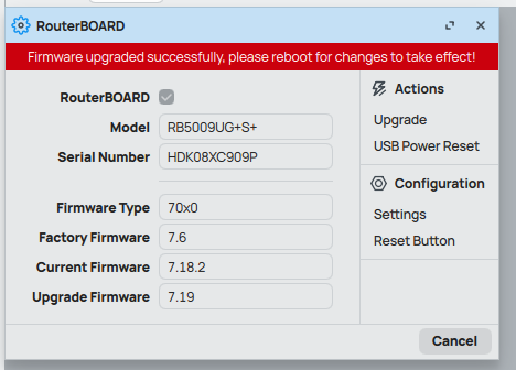

Your router still shows the factory firmware version as 7.6, so you should be safe. If I am not mistaken, if you had upgraded RouterBOOT with the faulty package, then factory firmware would be shown as 7.18.2 instead of 7.6. Can the people affected with the issue confirm it?
He wrote the problem was with the universal package that updated the backup bootloader to 7.18.2 - yours does not look like having that installed.
yes, mine is 7.18.2
both pri and backup

If you do not update RouterBOOT with the “v7 Universal Package for All Architectures” from this link, this problem will not occur. This problem is caused by using this firmware update.
I have replaced the RB5009 from the seller and updated the system and firmware to 7.18.2, 7.19 through winbox without any problems
npeca75 - Router experiences problem when you install package from our help page: https://help.mikrotik.com/docs/spaces/ROS/pages/40992878/RouterBOARD#RouterBOARD-Protectedbootloader
This package is NOT required in order to use protected bootloader. It is required only if:
  • Protected bootloader does not work out of the box
  • Factory firmware is old
  • And you see the warning stating that you must install this package
RB5009 did not show such warning. RB5009 can use protected bootloader without any universal package installation.
We have updated manual just now to make it even more clearer.
tnx for clarification, but it is late now
i have last running unit RB5009 with both 7.18.2 bootloader
and i am afraid, it will not boot anymore after reset/power cycle
so, please, from where to download FIXED bootloader package ?
before this last 5009 die …
