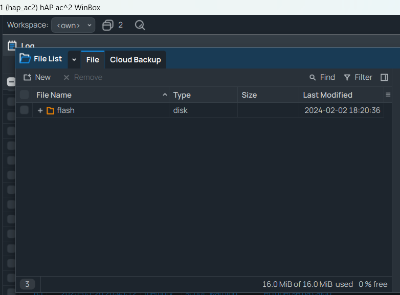

After upgrading to version 7.19.1 in my hAP_ac2
